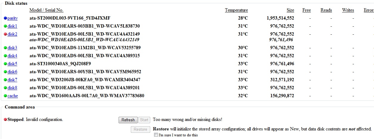

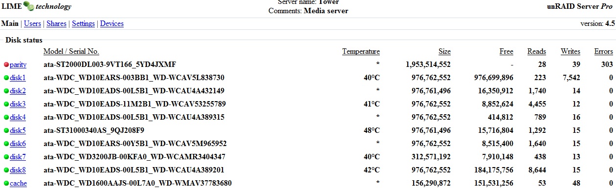

August 3, 201214 yr Author Hi, thanks for responding! Attached is a screenshot, I hope it helps? I do still have the old drive which I expect could be re-added to the array (and once parity ran might give me another chance at this?). Disk1 is the drive that I replaced, and it is slightly larger than the one I removed (only by a few k).
August 3, 201214 yr It appears you formatted the new disk1 disk you installed. In addition, you do not have valid parity. The parity disk looks to have been taken out of service. (it shows over 300 read errors) Step 0. Post a syslog. Step 1. Get a SMART report for the parity disk. If it is going bad, no sense re-calculating it. Step 2. Put the original disk1 back in. Since it is smaller you will need to set a new disk configuration in order to have the array start. This will immediately invalidate parity, but since you do not have valid parity at this time, you have nothing to lose there. When you then start the array it will begin a new initial parity calculation. Once done, you are back to where you were. (but probably with a failing/near-failing parity disk) Step 3. Since the parity disk has issues, replace it with the disk you were initially attempting to use to replace disk1. When you start the array, it will completely re-calculate parity. Now, you are back to healthy parity, and disk1 with an HPA. Step 4. Run a parity check to make sure you can read the parity you just wrote to the parity disk. Wait a week.. to make sure all is stable. In that time you can consider RMA'ing the old parity disk, or purchasing an additional disk. Do NOT press a Format button... ever ... unless you are adding an ADDITIONAL drive to your array. It is NEVER used when replacing an existing disk. Do not press the Format button if there are multiple disks showing as "unformatted" when you only added a single additional disk. Seek assistance.

August 3, 201214 yr Hi Joe, thanks for the reply. I have attached the syslog but cannot generate a SMART report for the drive. I have tried the following without success: smartctl -a -d ata /dev/sdd >/boot/smart.txt smartctl -a -A /dev/sda >/boot/smart.txt smartctl --all /dev/hda >/boot/smart.txt The parity disk device is /dev/sdd You might try smartctl -a /dev/sdd >/boot/smart.txt and see if it responds. (it might not if really dead, or locked up, as there are LOTS of errors in the syslog.) You may have to power cycle the server before it will respond again, or it might not ever respond again. In any case, writes to it failed, so it was taken out of service. (disabled) As of the time you captured the syslog, unRAID was trying again and again to spin down the parity disk... (apparently, with no success) I'd try a power cycle (power down, make sure the power and data cables to the parity disk are re-seated and secure, then power up) Joe L. Joe L.
August 3, 201214 yr Author Thanks Joe. That worked, and attached is the SMART report. However... Since the point of all this was to resolve HPA issues so I can upgrade, I tried hdparm on disk 2 before rebooting. It seemed to work, but upon reboot the drive is offline. I ran "hdparm -N /dev/sdf" and get "max sectors = 1953525168/1953525168 HPA disabled" which is what I would expect, so not sure what's wrong... screenshot and syslog attached. (sorry, had to zip files to meet upload limits) unraid.zip

August 4, 201214 yr Does the reported size match the other drives? Since parity and disk2 have failed the contents of disk 2 is not recoverable and must be restored from an independent backup.
August 4, 201214 yr Author There seem to be 2x values for the size (see attached). Should I be selecting the "restore" option now?
