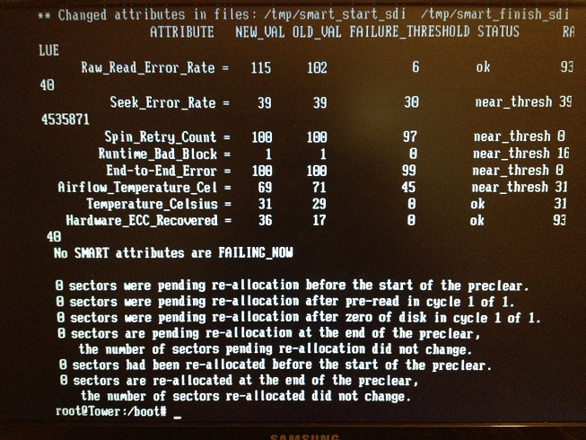

September 1, 201214 yr Author Preclear finished on my other drive and I was able to add to the array without further issue. The results didn't look as promising though (see attached). Should I be worried about this?
September 3, 201214 yr i actually would've run the preclear again. TBH i'm not sure if that is ok or not.
