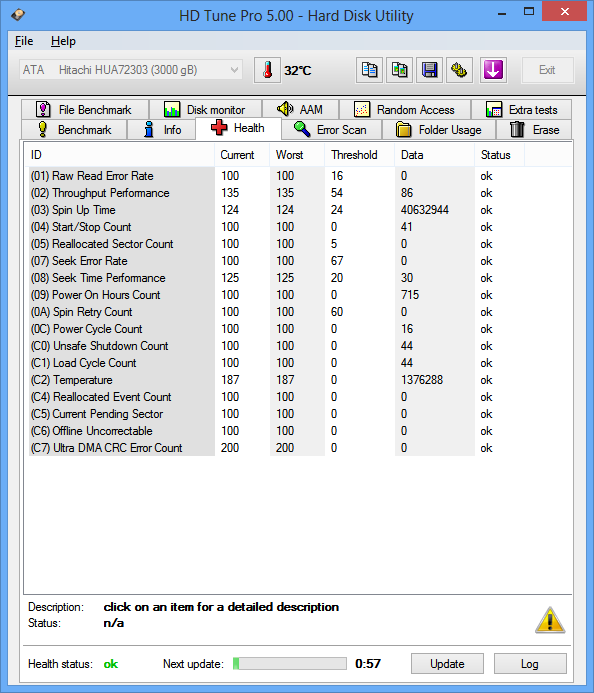

I have checked the SMART values on disk9 and there is abosultely nothing wrong. I am using HDTune to check the drive for errors.
Post the full smart report... please...  Unless you do not really want any help.  I am doubting you have the same level of experience as the collective minds that assist with analysis.

I checked one other drive before shutting down and unraid gave a smart report. I have now replaced disk9 with a new one and put the original disk9 in a Windows 7 computer and so far there are no issues.

There is no evidence of anything wrong with the drive here, and your SMART report confirms that, so you can feel confident the drive itself is fine.
