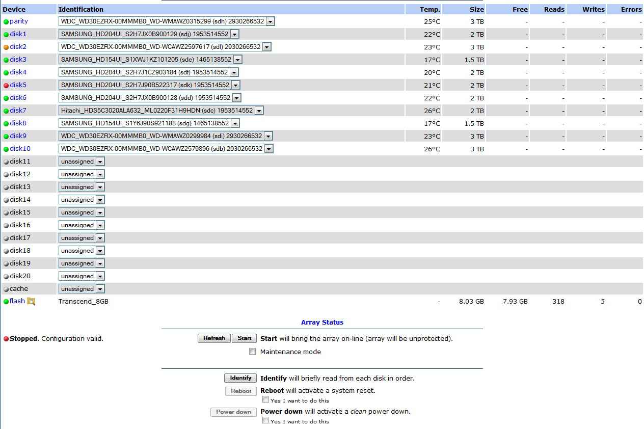

I've encountered a serious problem, i think. I tried to upgrade a 1TB drive with a brand new 3TB drive. All balls were green, except the one next to the new drive, which was orange. Unraid recognized it correctly as an upgrade.
I then started the array and it began the reconstruction on the new drive, but within a few seconds a red ball appeared next to another drive. I paniced and pulled the power switch to shutdown the pc.
After the restart of the pc i am now stuck with a red ball to one drive and an orange ball to the new drive. In my attachment you can see the situation. I could restart the array but without protection. But how is that possible, aren't there 2 missing drive an my whole array would be invalid?

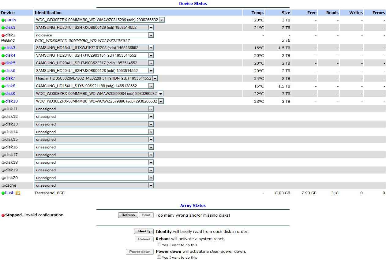

@GortWillSaveUs: I tried that before and took a screenshot. As you can see in my Attachment the old drive isn't recognized anymore and unraid asks for the new 3TB drive. I haven't changed anything on the old 1TB drive.
@trurl: I think that was the reason for initial occurrence of the error. But now unraid has set the drive to some kind of error state and fixing the wiring will not help.
My thought would be to put the original drive back in disk 2 and then see if I could get the red ball to go away on disk 5. unRAID is not going to do a drive upgrade with an invalid configuration anyway. Maybe if you could get to that point you would just have invalid parity and all your data would be intact.
