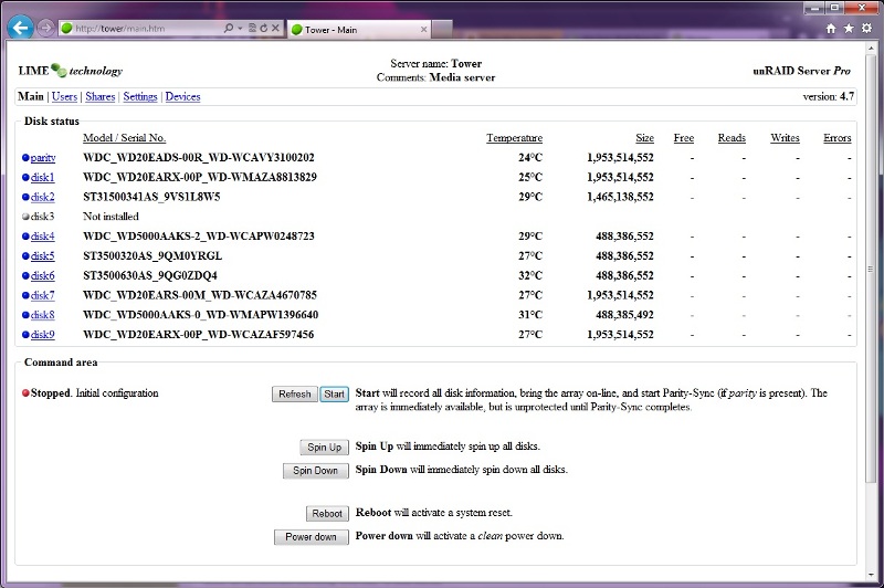

I somehow had a simultaneous failure of both my USB flash drive AND one of the hard disks in my array.  To top it off, I did not have a backup of the config on my flash drive either!  Where I am at now is that I re-installed UNRAID on a new flash drive, put my license key on it, and rebooted with the drives attached.  It came up with no drives assigned, so I assigned each of the disks to the same slots they were assigned to before...
However....  the failed disk does not even register in UNRAID as an attached drive, so right now the slot it should be assigned to in UNRAID is currently showing as unassigned.
I need some advice on what to do next please.....
1) Do I bring up the array leaving the disk unassigned and showing as "not installed" on the main screen?  Since my original flash config is gone, UNRAID does not see the disk as missing or being upgraded - it sees it as UNASSIGNED and I am worried that when it starts the parity sync, it will assume that whatever data drives are there is what should be there and then it will recalculate parity on the parity drive which will of course be all wrong, and the entire array will be destroyed.
or....
2) Do I replace the disk and assign it to the slot where the old one was.  I am thinking that if I do this though, when I bring the array online and it starts to do the parity sync, the data on the new disk will be incorrect of course, in which case when it calculates parity it will all be wrong and then it will overwrite the good parity on the parity disk and once again my entire array will be destroyed.
I've attached a screenshot of my current situation.
Can anyone help me and let me know what I should do next??  I am really worried I am going to lose everything and I don't want to do anything before I know the consequences.  Right now everything is powered down and I have not done anything else.
Thank you in advance!!!!!

I have not started the array yet or done anything other than re-assign the disks to the exact same slots they were in before the USB failure.  For the failed disk, I have left this slot as currently unassigned.  After making these assignments, I did NOT start the array, I just powered everything back down and am awaiting an answer on how to proceed next.
The difference I see here is that since the original config is gone, unraid does not see the missing disk as one that has failed, but rather one that is not installed - see the screenshot (it thinks everything is brand new).  I am guessing that this is a completely different scenario when it comes to starting up the array and doing a parity sync?
I don't know if I put a new disk in it's place if it will mess up parity thinking it is the old data disk, or if unraid will be smart enough to recognize that the new disk is not using the unraid file system and treat it as a replacement for the old disk and start to rebuild it?  Does unraid know by looking at the parity disk, how many disks in total should be in the array?

Here's the first issue. From reading past posts, it seems the set invalid slot command will cause a drive rebuild without the proper partition being created on the disk. So, what you first need to do is to assign the replacement drive as the only data drive in the server and start the array. You can format the drive when the array is started if you want, but it's not necessary.
So, assign the replacement disk as the only disk in the array, say disk1.
Type "initconfig" on the command line and press enter.
Refresh the web page and the disk should be blue.
Press Start.
Next is to setup the correct array. The main things are to make absolutely 100% that you have the parity in the correct spot and you know where the replacement disk is located.
So, stop the array with the single disk.
Assign all the old disks the disks to their correct slots.
Assign the replacement disk to it's location.
Now, type the "initconfig" command again.
Refresh the web interface. All the disks should be blue.
Next type "mdcmd set invalidslot 3"  --> this is assuming the array is like your picture and the replacement drive is in the disk3 location. Otherwise, use the disk number where you assigned the replacement disk.
The older versions gave an output to this command but 4.7 does not. So, this is the point where you take a leap of faith, cross your fingers and press the start button.

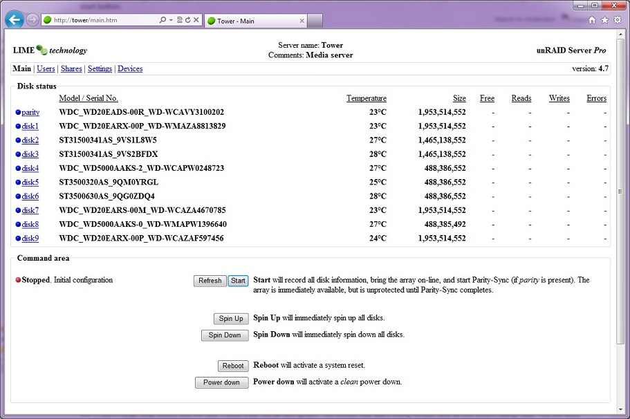

I have followed your instructions to the letter and everything has gone as you described so far.  However, I am at the very last step, and I need to confirm this before I start the array.  After typing "initconfig" for the second time (with all of the disks including the replacement disk assigned), I got blue balls next to all of the disks as expected.  I proceeded to type "mdcmd set invalidslot 3" for the new disk.  There was no feedback on the command line console, also as expected, but it seems to have accepted the command.
Here's my question - I refreshed the web interface and all of the disks still show with blue balls next to them (see attached screenshot).  Shouldn't everything have turned green or is it ok to start the array with everything blue?  Even the replacement disk should also be blue?
Please confirm as I am so anxious to get this array back online again!!
Thanks!!!

The initconfig command will turn everything blue, which is the indicator for new disks or new array.
The set invalid slot command just tricks the raid engine into "building" disk3 instead of "building" parity. You MUST NOT refresh the web interface after using the command so they won't be able to change colors.
I re-read your posts and I answered your one question wrong. I posted they would turn green, but I meant after pressing the start and not after a refresh. Damnd good thing you took your time and posted again.
Ok so since I DID refresh the web interface after issuing the invalidslot command, now what?  Should I enter the command from the command line console again and then hit start?  Not sure I understand how refreshing the web interface would have any effect?  I am confused now!  The array is stopped per the screenshot.  What do I do next?
Yes
Because the "md" driver is re-initialized every time you refresh the screen while the array is stopped.  This is to allow it to recognize any new drives you might have plugged in while it was stopped.  Basically, when it re-initialized, it undid the set invalidslot you issued.
Hope this helps.  Issue another set invalidslot command, do NOT refresh the screen, press "Start" instead, (if religious, say a prayer or two  ;D, if superstitious, do not walk under a ladder  8) or break any mirrors.  ;D)
What Joe posted. You have to issue the command and then press start without refreshing the main web page.
You re-issue the set invalidslot command and press start, assuming it's still sitting like your screen shot shows and you still have that window open. If not, open the web interface first, issue the command and then press start.

Once the array is started you can refresh the screen, and you should see one disk being written to heavily, and all the others being read heavily.
If the disk being written to is the wrong one... sorry.  (hit Stop/cancel rebuild)
Joe L.
Thanks Joe.  As long as "mdcmd set invalidslot 3" corresponds with the "disk 3" position I should be good to go!
Joe L. and Lionelhutz... THANK YOU!!!  Disk 3 is rebuilding now so things are looking good!  I can't thank you enough for all your your guidance.  I really appreciate it.
