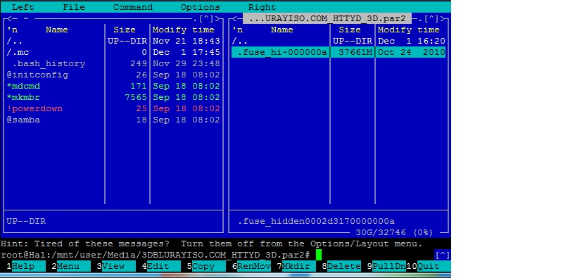

Today I stumbled upon problem. I tried to delete a directory from my server with an attached Windows 7 laptop. I got a message that it could not be deleted because it was open in another program. I then tried to delete the file in a telnet session with MC. I still can't delete the directory because it is not empty. There is indeed a file like shown in the attachment. Where does this file come from and how to delete it? It's over 38 GByte.

You can rm the .fuse_hidden file, but it just adds another after incrementing the number after .fuse_hidden.
Turn off shares or start in maintenance mode then rm.
