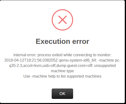

  8. So I probably need to reinstall Mac OS i would imagine? So recreating the VM (rebuilding the xml, etc.) worked just fine. My VM is back. Thanks 1812, and thanks Squid. You guys rock!
  9. Now that...is a bummer. I'm sure you can guess the ramifications....the VM won't boot now. Has anyone else out there gotten their Mac VM to run with 6.5?
  10. Squid- you are the MAN. I am able to start my windows VM. thank you sir! there is one issue that I'm still trying to figure out. I have a Mac VM as well that has always worked. I get an error (screen shot below) when trying to start it. Here are the logs. If you need more diags, etc. please let me know. 2018-04-12 18:19:13.072+0000: starting up libvirt version: 4.0.0, qemu version: 2.11.1, hostname: Emperor 2018-04-12 18:19:13.072+0000: Domain id=1 is tainted: high-privileges 2018-04-12 18:19:13.072+0000: Domain id=1 is tainted: custom-argv 2018-04-12T18:19:13.097941Z qemu-system-x86_64: -machine pc-q35-2.3,accel=kvm,usb=off,dump-guest-core=off: unsupported machine type Use -machine help to list supported machines 2018-04-12 18:19:13.149+0000: shutting down, reason=failed 2018-04-12 18:21:06.816+0000: starting up libvirt version: 4.0.0, qemu version: 2.11.1, hostname: Emperor 2018-04-12 18:21:06.816+0000: Domain id=2 is tainted: high-privileges 2018-04-12 18:21:06.816+0000: Domain id=2 is tainted: custom-argv 2018-04-12T18:21:06.841592Z qemu-system-x86_64: -machine pc-q35-2.3,accel=kvm,usb=off,dump-guest-core=off: unsupported machine type Use -machine help to list supported machines 2018-04-12 18:21:06.861+0000: shutting down, reason=failed 2018-04-12 18:21:56.013+0000: starting up libvirt version: 4.0.0, qemu version: 2.11.1, hostname: Emperor 2018-04-12 18:21:56.013+0000: Domain id=4 is tainted: high-privileges 2018-04-12 18:21:56.013+0000: Domain id=4 is tainted: custom-argv 2018-04-12T18:21:56.038205Z qemu-system-x86_64: -machine pc-q35-2.3,accel=kvm,usb=off,dump-guest-core=off: unsupported machine type Use -machine help to list supported machines 2018-04-12 18:21:56.089+0000: shutting down, reason=failed Below is the error window... Any help is appreciated!

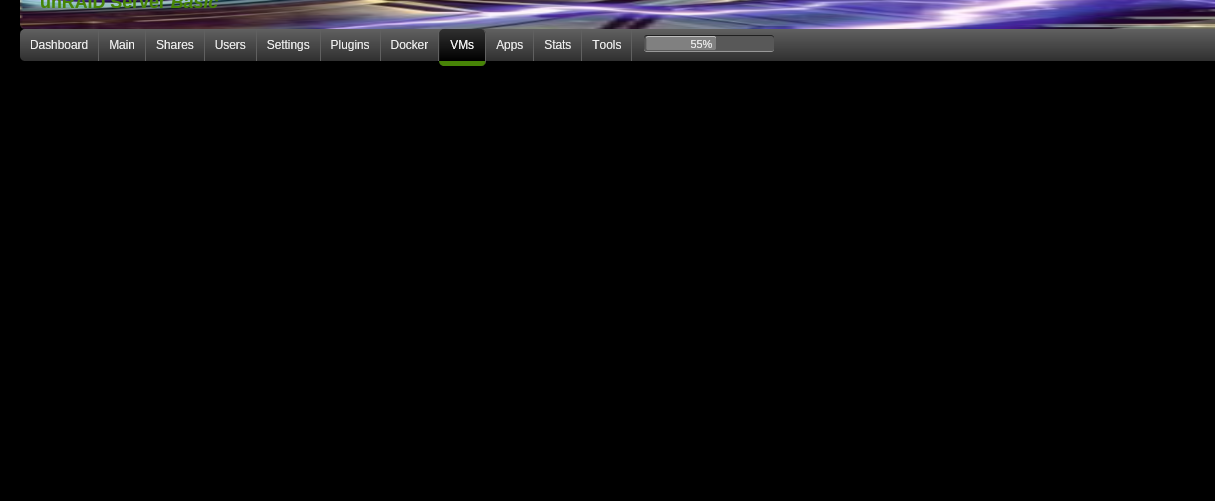

  11. Thanks Squid- thats just it. I can't even view the settings any longer. Diags are attached. Any help is appreciated! emperor-diagnostics-20180412-1144.zip
  12. In fact, I do not even see anything on the VM's page. No option to start existing, no option to create new VM
  13. right...besides you i guess.
  14. I just upgraded to 6.5 and my VM's are gone as well. VM's are enabled, but they are gone. Has anyone else seen this?
