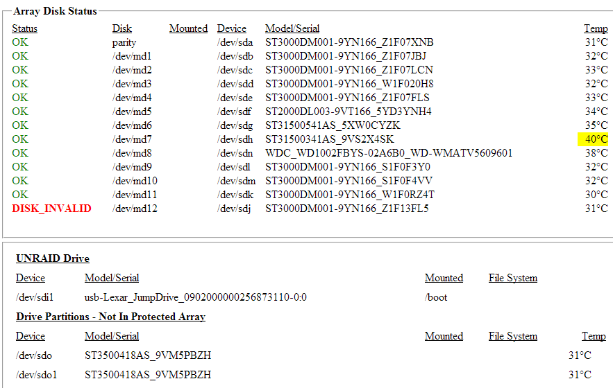

My server hardware stats are in my signature and I have attached a picture of my configuration page.
Please let me know if you need anything else to help me, and I would be glad to provide it.

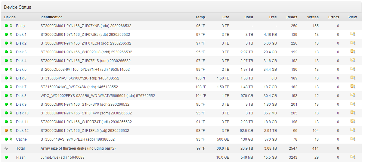

Please post screen shot of 'stock' webGui Main page.

Hello Limetech,
I am running simple features, so i'm not exactly sure it is stock. I am unsure on how to remove simple features. I tried to look it up but could not find any info on how to boot to the default interface instead. I have Attached a screen shot of the simple features configuration page, if that is not adequate, please let me know, and I can try and dig further and figure out how to disable it.
Just an FYI, I do have other plugins such as couchpotato, marachino, headphones, sabnzbd, sickbeard, darkstat, and airvideo.
However I have disabled them all so they are not running, as I was afraid they may have been causing the issue.

Hello Everyone,
After about 6 hours of rebuilding parity, it failed stating I have write errors on disk 9, which is another newer 3 TB drive. It is highly unlikely that I have this many failed drives. Something else has to be going on, either its a cable, my AOC controller, or there is something wrong with Unraid 5 RC8.
Attached is the log I was able to pull stating that there were write errors on disk 9.
The only things to try that I have left are the following;
1. Replace cable
2. Downgrade to Beta 14.
3. Replace SUPERMICRO AOC-SASLP-MV8
As always any suggestions would be greatly appreciated.
Thank You
Syslog2.txt
