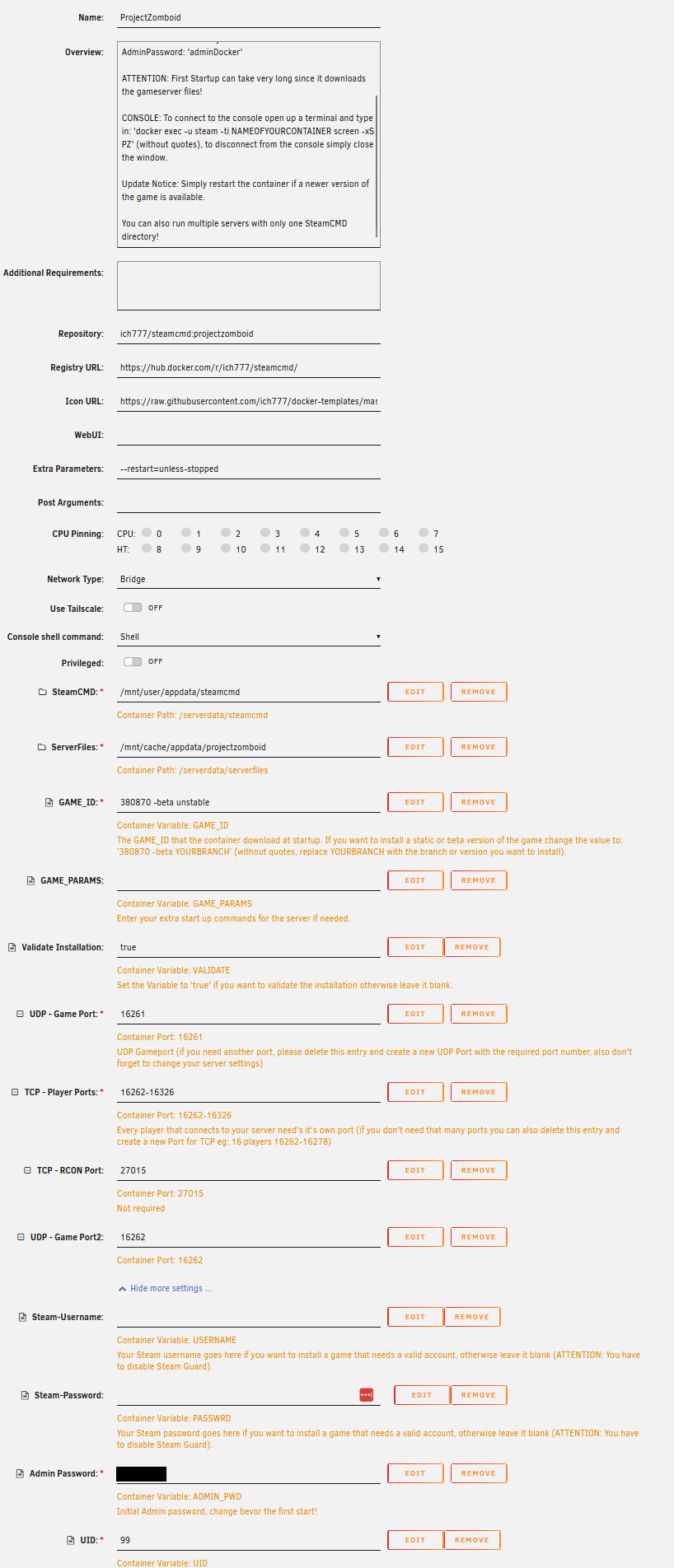

  1. @HillyBilly Try deleting everything again and then running this from CLI: docker run -d \ --name='ProjectZomboid' \ --net='bridge' \ --pids-limit 0 \ -e TZ="America/Los_Angeles" \ -e HOST_OS="Unraid" \ -e HOST_HOSTNAME="Unraid" \ -e HOST_CONTAINERNAME="ProjectZomboid" \ -e GAME_ID="380870 -beta unstable" \ -e GAME_PARAMS="" \ -e VALIDATE="true" \ -e USERNAME="" \ -e PASSWRD="" \ -e ADMIN_PWD="REDACTED" \ -e UID="99" \ -e GID="100" \ -p 29015:27015/tcp \ -p 16261:16261/udp \ -p 16262:16262/udp \ -p 16262-16326:16262-16326/tcp \ -v /mnt/user/appdata/steamcmd:/serverdata/steamcmd:rw \ -v /mnt/cache/appdata/projectzomboid:/serverdata/serverfiles:rw \ --restart=unless-stopped \ ich777/steamcmd:projectzomboid Modify the password and host info to suit your server, and see if this fixes things. Just to double check you don't have an old servertest.ini anywhere loading up mods do you?
  2. I did the following: - Deleted Container and Image - Deleted /appdata/projectzomboid - Deleted /appdata/steamcmd - Ensured I wasn't doing any port translation from within the container to the host. - Re-did my servertest.ini -Ensure no mods are added
  3. Hooray! I can confirm the server is up and running and I was able to connect to it! Thank You @ich777
  4. @ich777 I apologize, I should have said more. It's my assumption at this time that PZ Unstable Build of 42.13 likely doesn't work yet with standalone multiplayer servers. They even elude to it in the patch notes: - We strongly recommend only playing in coop or on whitelisted servers. I was just trying to get the conversation started, if any changes needed to happen to the container. Also I should have shared the SQL Lite error, but I was having difficulty grabbing it because the container would close my log window when it would reboot. Im hoping a hot patch will eventually come out that might help. Thank you for the work that you do!
  5. ProjectZomboid Version 42.13 is out with multiplayer. I tried to run it by doing this: docker run -d \ --name='ProjectZomboid-The_Boys' \ --net='bridge' \ --pids-limit 0 \ -e TZ="America/Los_Angeles" \ -e HOST_OS="Unraid" \ -e HOST_HOSTNAME="Unraid" \ -e HOST_CONTAINERNAME="ProjectZomboid-The_Boys" \ -e GAME_ID="380870 -beta unstable" \ -e GAME_PARAMS="" \ -e VALIDATE="true" \ -e USERNAME="" \ -e PASSWRD="" \ -e ADMIN_PWD="REDACTED" \ -e UID="99" \ -e GID="100" \ -p 29015:27015/tcp \ -p 16261:16261/udp \ -p 16262:16262/udp \ -p 16262-16326:16262-16326/tcp \ -v /mnt/user/appdata/steamcmd:/serverdata/steamcmd:rw \ -v /mnt/cache/appdata/projectzomboid:/serverdata/serverfiles:rw \ --restart=unless-stopped \ ich777/steamcmd:projectzomboid however it fails even on a fully clean boot there is some sort of issue with the SQLLite DB where it is tripping up on creating a table that already exists.
