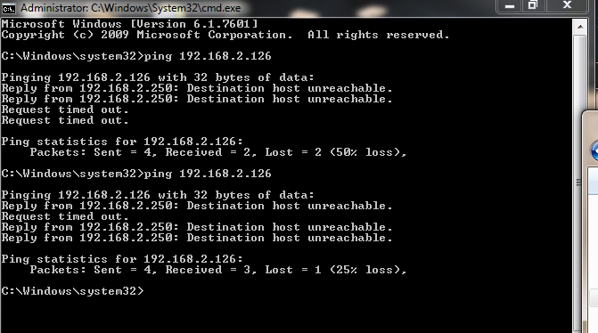

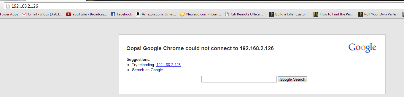

Yes that is the IP but that IP does not show up anywhere on my connected devices list on the router - any idea why? Also neither IP address nor name works. Pinging also did not work.

So you've tried:
Try http://192.168.2.126 via web browser on your desktop
and tried
'ping 192.168.2.126' on your desktop, both failed?
Couple of things we can do at this point. (This assumes your desktop & unraid both get DHCP from your router).
A:) Reboot router and wait 5 minutes. If the router is messed up, it could block comms from either machines.
B:) on desktop (assuming it's a windows box) ipconfig /flushdns and then a arp -D (clears dns entries from machine, deletes all arp cached entries)... doing a arp -A will show you the network connections of everything broadcasting on your network. (including broadcast addresses)
C:) on unraid box, remove network cable for 60 seconds. you could also accomplish by a (local command, not over network) ifconfig eth0 down then 60 seconds later ifconfig eth0 up (this command causes the network interface to stop then start (requesting a dhcp allocation). However, pulling the cable often accomplishes this with far less typing.
D:) ping 8.8.8.8 from the unraid box, if you can do this, you've got a good network connection, and can communicate with the outside world (aka go through router). If at this point you can't reach the ip (from ifconfig) of the unraid box on your desktop, something is blocking the communications from your desktop to unraid. at this point I'd blame your Antivirus/firewall or stock windows firewall. Something is blocking those communications.
*** Also, to see the variety in network failures on the ping makes me think - unreachable & timed out.. that's unusual... it's possible (unlikely but possible) that you've got bad cabling or switches in between.
