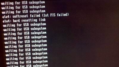

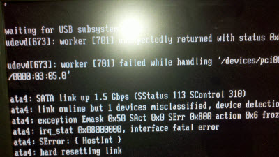

Ok, I have download 5.0 rc8a and copied bzroot and bzimage from the zip file to my existing 4.7 settings located on the USB. Removed passwd and smb password from the USB config folder. The build was going well until I received a "waiting on USB subsystem error."
This issues seems to be a continues loop error and I am unable to sign in with root with 5.0 rc8a to pull a syslog.
If I receive a USB Subsystem error after 1/2 Unraid system was loaded.  Is this error due to the USB failed? Would it need to be replaced?

Followed the directions from the link listed below for upgrading v4.7.
However I received "waiting on USB subsystem error."  Never have the ability to set a tail syslog or pull a system log.
I attempt to take a snapshot
Try copying syslinux and make_bootable from the new distribution to the flash and then run make_bootable as Administrator. This will do no harm.
