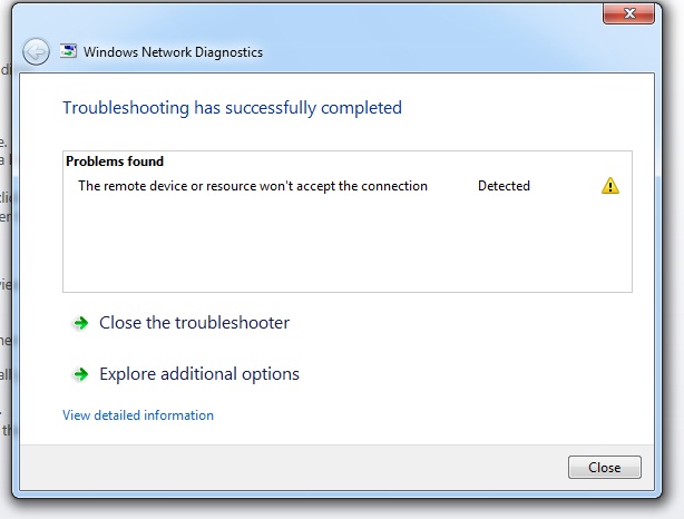

I dug a little more to find out that it wont accept a connection. Could it be that unraid is doing somthing in the back ground and I need to wait it out? There is no noise or hard drive light indicating it's doing anything. I've force turned it off a couple times upgrading the software and all still give me the flash folder on windows 7 machines. all drives are powered on for sure pulling full watts. So I know that much monitoring it. Is there any way to also go into the USB drive and change the auto start unraid to off and atleast be able to see the drives and whats going on? Do I maybe need to rebuild my USB fresh and apply pro license and when starting unraid it asks me to reconfigure the order of the drives?
Thank you again,

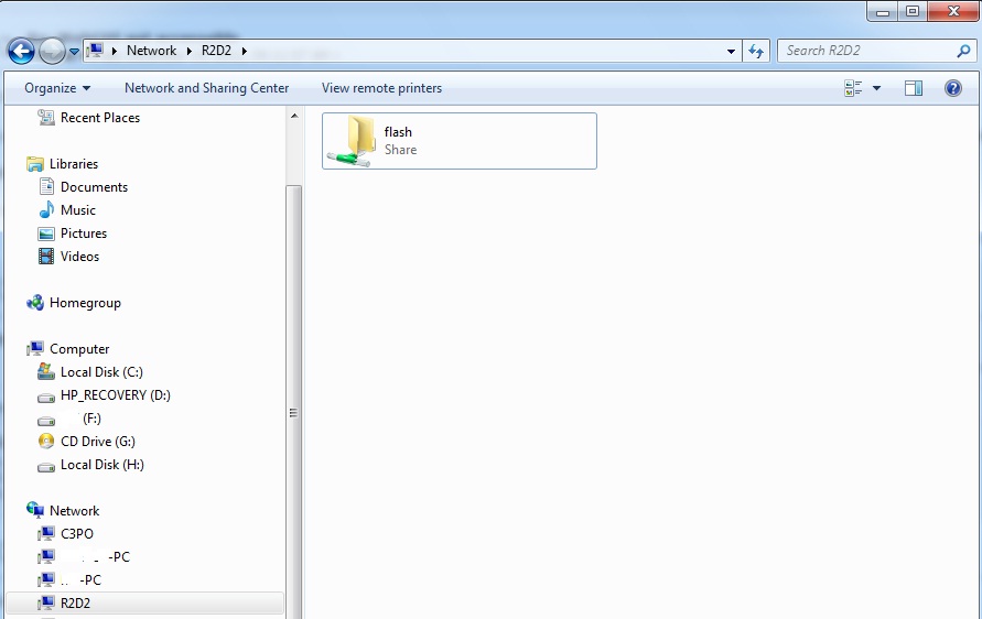

This is what I see on my Windows7 Machines.
It was when it went down. I'm talking about the GUI I've had sharing turned on there for many months. It's like the drive and the shared folders just fell off. As you can see the only thing I can now see is the flash folder. Also the same with my XBMC machines. I just wish there was a way to tell what it's doing if the telnet screen just says login:
Attach a syslog. See the sticky in this forum.
