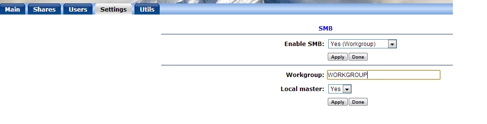

On step one of your answer i did just that but (screen capture added called workgroup) all machines say WORKGROUP, so i typed in WORKGROUP but if i put another name in that box instead of WORKGROUP then it seems not to make a difference.

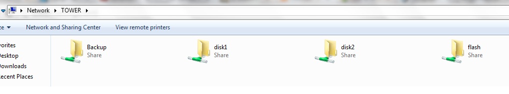

3rd, i do see it in network (img called network is added) but if i add a folder called movies, music, software etc... would i add it in the disk 1 and ? and if so how does that share them between 2 disks (it looks like under network i can just add the movies to disk 1 and it wont share it to the other disks ?

Looking at your screen capture called 'network.jpg', it appears that you have four shares available for browsing at this point:  'Backup', 'disk1', 'disk2' and 'flash'.  (BTW, 'flash' is the flash drive with your unRAID software and settings on it.)
If you click (or double click) on any of these shares, you will see a listing of directories (folders in Windows) and files that are stored there.  I would guess that Backup, disk1 and disk2 are blank at this time.  However, you can copy files to those shares; You can copy files from those shares; you can delete files from those shares; you can read the files after they are copied there.  (You should most cautious about writing or deleting from the flash share.  Use the other shares for any experiments until you know what you are doing!)
Grab a file, drag it, and drop it on one of the shares  (Backup, disk1, or disk2) and the file will be copied there.  Just like you do with a 'drive' that shows up under 'Computer' in Windows.
Hope this helps...
Hope this helps...

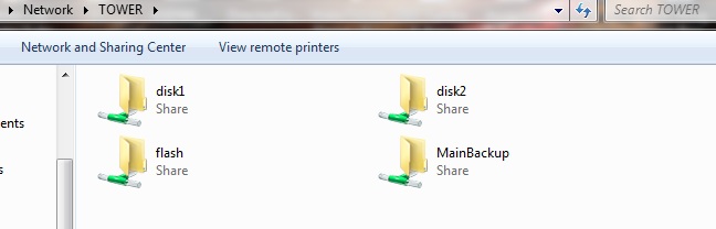

So i logged n from my laptop that's on the network and the user names was root with password, i added files onto the MainBackup file (in the img) and then i clicked on disk 1 and saw the same files as the files in MainBackup but when i clicked on disk 2 i saw nothing.
Under "shares" i have MainBackup and the split level to 1,

So when i open up the network i get the Flash, Disk 1 and Disk 2. I made a shared folder called MainBackup. I would like it when i place folders in MainBackup that it will automatically load the files where it can on Disk1 and 2 as it sees fit "i think that's what high water will do" ?
Yes; although, split level has precedence over allocation method.
