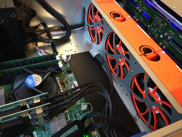

Take a look at the videos on the xcase website and they will explain but from what I can see they have better caddy retaining springs and airflow. I was having problems with the mini sas cables blocking the noctua fans so backed it and went for the 424 pro model with hot swop quiet fans. It's so well built, I think it's based on a chenbro case where as the one I had before is a modified Norco case.

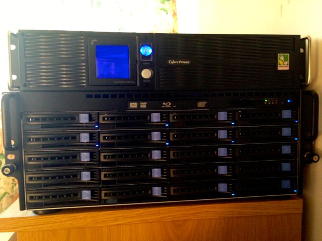

The RM 420 Pro case is excellent, I went down to the 20 bay unit as Im never going to need 24 drives. I'm running 10 x 3TB WD Reds at the moment with two used for parity, I changed to an Adaptec 7 series 16 port HBA due to its low power usage as well. At the moment Im using WHS 2011 and Transparent RAID as I wanted to use the My Movies WHS automatic ripping feature but Im in the process of building a smaller system with 6 x 4TB WD Reds to use with Unraid as a simple NAS. The case with all 10 drives and a slimline Blu-ray drive in use is consuming 83 watts so its very power efficient. I went for a rack mount case for future expansion but Im starting to wonder if its overkill for a simple media storage unit although its very quiet and keeps the drives all at about 31 degrees with the internal fans running at 975 RPM and the CPU fan at 900 RPM. To be honest the stock intel Xeon cooler and fan make more noise than the internal fans. I have a rack mount cyberpower PR1000 UPS connected as well which again is overkill and gives me 2 hours running time when I have a power cut.

The case with all 10 drives and a slimline Blu-ray drive in use is consuming 83 watts so its very power efficient. I went for a rack mount case for future expansion but Im starting to wonder if its overkill for a simple media storage unit although its very quiet and keeps the drives all at about 31 degrees with the internal fans running at 975 RPM and the CPU fan at 900 RPM. To be honest the stock intel Xeon cooler and fan make more noise than the internal fans. I have a rackmount cyberpower PR1000 UPS connected as well which again is overkill and gives me 2 hours running time when I have a power cut.

Yes that is exactly what Im doing. I have a friend staying with me long term and the NAS is in his Bedroom (my only spare room) and he needs the space. I will sell it as is or strip it down and sell the parts and build a smaller unit that I can put in my bedroom hence the need for the new one to be quieter, he sleeps through the 20 Bay unit in his room though so you can imagine its very quiet as well but I just don't have the space for a sever cabinet in my bedroom and I don't want it in the lounge. I could put it and the UPS in the garage but as the 20 Bay unit and UPS are high spec high end and cost a lot to build I don't want it in a damp garage.
If I sold my server as is to build a more compact unit would anyone in the UK be interested in buying it. It cost me £1700 without the hard drives and everything is still under warranty being only 5 months old maximum and I have all the receipts. I also have the Cyberpower 2U PR1000 Vertical mounted on the included stands or Rackmount UPS for sale with 2 1/2 years warranty remaining. It is silent in use. Let me know if anyone is interested, Im prepared to lose money but Im not going to give the server or UPS away for silly money.

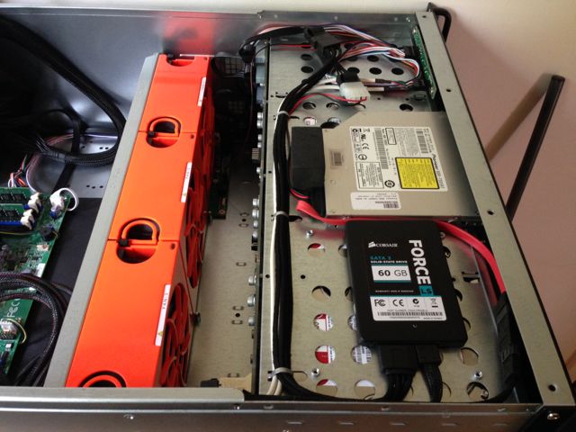

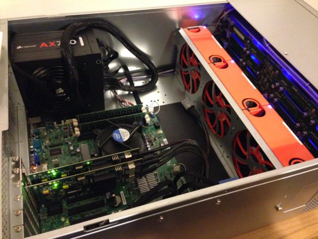

The current specs are as follows, I will keep the BD drive as Im going to use it anyhow but will leave all the cable and connectors in case anyone wants to use one. I will just replace the original black steel blank where it was.
Case: X-Case RM420-Pro, 20 Bay 4U Rackmount, Mini SAS Backplane, 3 x Temp controlled 120mm Hot Swop Fans.
PSU: Corsair AX760 Platinum
Motherboard: Supermicro X9SCM-IF
CPU: Intel XEON E3-1240V2
Memory: Kingston PC3-12800 ECC DDR3 1600, 2x8GB (16GB Total)
HBA: Adaptec 71605H, 16 Port 6Gb/s PCIe 3.0
SAS Cables: LSI LSI00400 60cm SAS Cable - SFF8643 (HD) to SFF8087 x 5
SSD: Corsair CSSD-F60GBLS LS
SATA Connectors: Bitfenix & Silverstone Black Sleeved
Blu-ray Drive: Pioneer BDR-TD05RT, 6 x BDRW
3 x spare hot swop 120mm fans, 1 x spare hot swop fan backplane, 4 x spare hard drive caddies.
