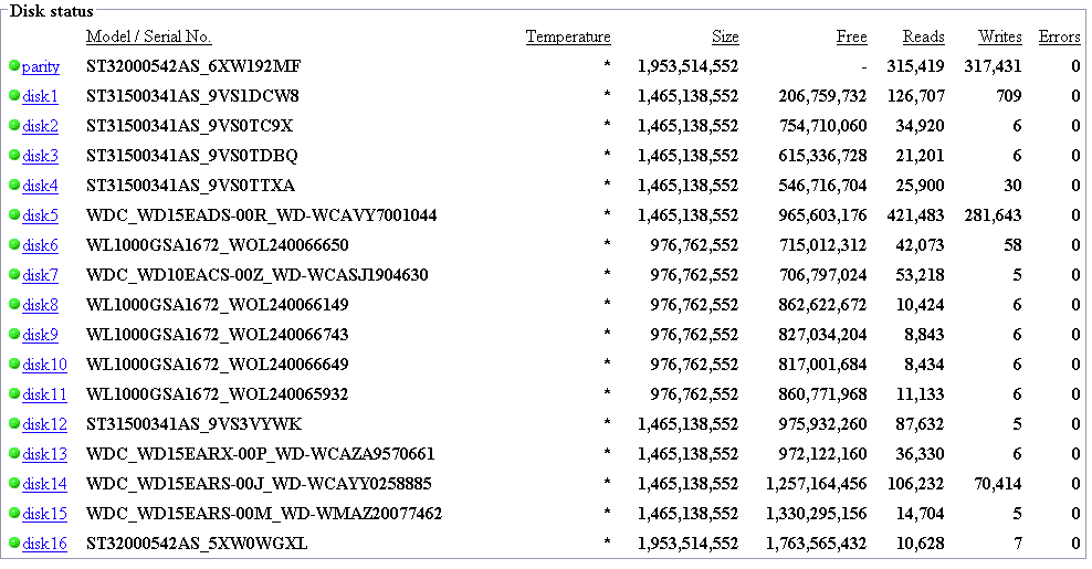

Hello Everyone - I have been a VERY long time user of the Unraid and have one of the original CoolerMaster towers fitted out with newer dense cages and currently a total or 18 drives and over 20TB in total storage.  Despite an occasional drive failure now and then the system has served me well.  I'm currently running 4.5.6 and have avoided the upgrade to the most current version of 4 only because it offered features or fixes that did not apply to my situation.
So my question for all the experts here is this, should I take the plunge and move to version 5 when it goes GA...?  I'm a really simply user with only unMenu as an add-on and no plans to add much, well maybe airplay but that's it.  What would I gain moving to 5 or what could I loose..? How difficult would this upgrade potentially be and are there any pitfalls such as drive compatibility I should consider..? The attached jpg should give you all an idea of the drives I running currently, there are some of the drives that needed the jumper in there and the jumpers are installed.

I think you guys have convinced me to stay put for now.  My hardware is about 3 yeas old now (MB and Controllers) and the drives are between 0-6 years old.  It's all working great so I'm staying put.
