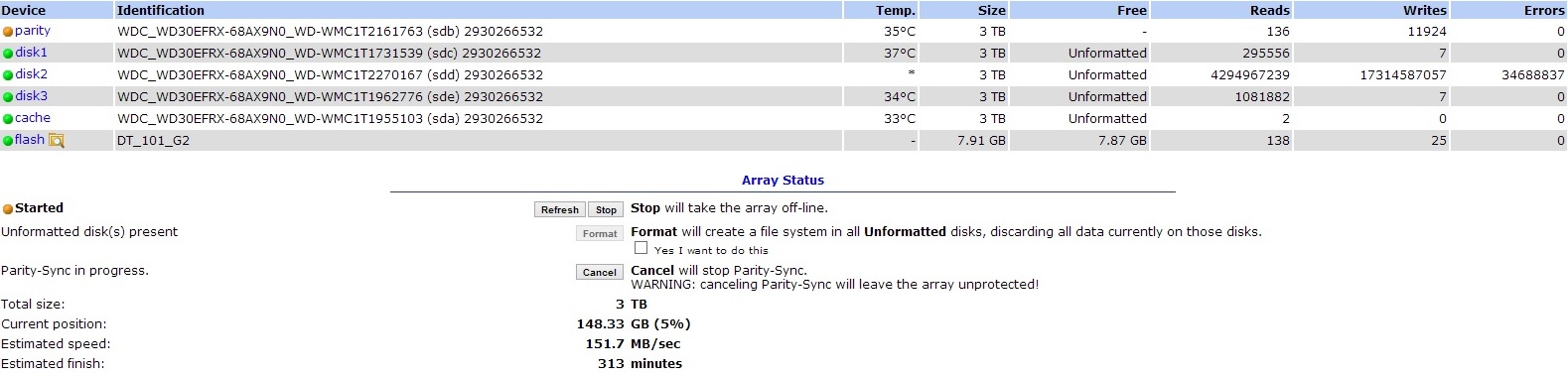

Disk2 is showing: Reads: 4294967239 Writes: 17314587057 Errors: 11671800
I am confused because preclear gave the drives a workout and returned no issue, but Unraid now tells me there are problems. The parity sync is continuing as I type and the reads, writes and errors are increasing. The parity disk, cache disk and the two other disks in the array seem fine.
I have attached a screenshot of my server MAIN window as of 2 mins before posting.
Can I please ask for some support from this forum. Am I missing something, have I really got a dud disk here or have I done something wrong?

A bit of an update. Parity sync is still running and the errors, writes and reads on this disk are increasing:
My syslog is showing masses of the following entries:
Feb  6 05:48:38 nas kernel: handle_stripe read error: 16230248/2, count: 1
Feb  6 05:48:38 nas kernel: md: disk2 read error

The really confusing thing is that it is showing all of your drives unformatted. Is there data on them?
Is it doing a correcting parity check? I guess it doesn't matter whether it completes it or not since if it is non-correcting it won't change anything, and if it is correcting it is too late anyway.
Just don't tell it to format anything if you have data on these disks. Someone else will have to help you with this one, but in the meantime you might try to get a syslog.
