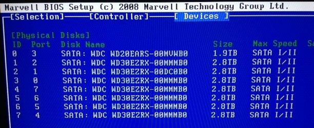

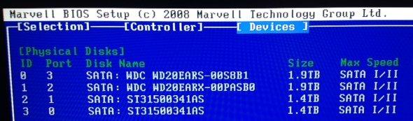

When I plugin both SAS-Cards at the same time, the SAS-Cards recognize all 12 HDD drives (Looked it up in the Configuration Menu of the SAS-cards). Unraid only Shows the drives connected to the x16 Slot. The drives connected to the second SAS-Card Show up missing.
