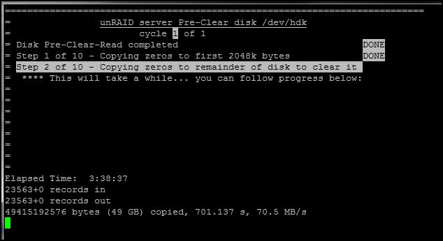

If the screens you posted above are all you're seeing, I don't think there are any Pre-Clear sessions running.      You should see a screen something like the following.
I would confirm that you have no active Pre-Clear sessions (by toggling through all sessions in Screen) ... and, if not, shut down the server;  then re-boot; and start ONE Pre-Clear session -- being sure you see the correct status screen when you start it.
... Otherwise, you may be waiting a LONG time for Pre-Clear to finish  :)
.... of course, if you DO have a good Pre-Clear status screen showing, then just wait for it to complete [although I'd still cycle through the screens to see if you have more than one running at the same time].

Note that when you start the pre-clear, the screen should look just like the sample I posted above (I took this from Joe L's pre-clear thread that outlines the process) ... except it will initially be in the pre-read process.

From the screen snapshots you posted earlier it looks like preclear was waiting for you to type "Yes" to confirm that you really did want to preclear the drive.
Perhaps that's all that's going wrong?
