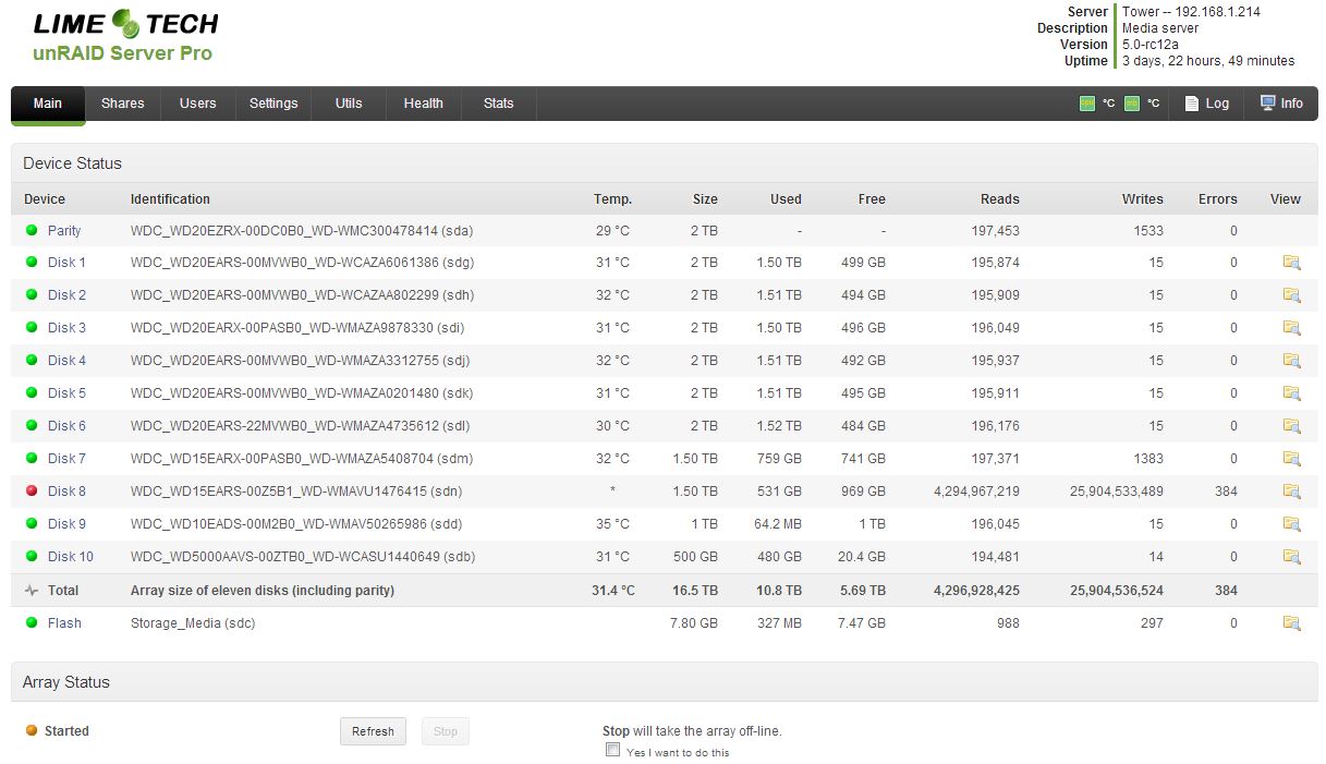

I setup unRAID about a month ago, precleared all drives, added them to the array, defined the shares and became a happy user. After about 30 days of uptime I noticed one drive became disabled. It had "sde" label. When it became disabled, the label changed to "sdn" and the number of errors increased to couple hundreds. I did the recommended procedure - stopped the raid, turned off the server, changed the sata cable, deselected the drive, started the array without it, stopped the array, selected the drive, started the array and waited for rebuild process to finish. Label became the old "sde" and everything worked fine for 3 days, then I noticed 2 errors and drive became disabled again. After I started the rebuild process it becomes disabled after 20 minutes, and I have to do restart rebuild couple times in order for it to finish.
Should I just replace the drive (however the smart report is normal)? Can I just take the drive out and rebuild the array, recalculate the parity (I have about 5tbs of free space on the array and the drive is 1.5tb)? Why label changes and how important is the order of letters? What would happen if I connect this drive to motherboard or other free sata port(now it's connected to HBA card)?

I'm not an expert, but it looks, to me, that something odd is happening to both of your 1.5TB drives (sde -> sdn, and sdf -> sdm).  I would check data and power connections to those drives (perhaps they're both powered through the same splitter?).  Are both of these drives connected to the same hba?
Also, check your psu - what make/model are you using?
In addition, looking at the syslog, I'm suspicious that perhaps one of your software addons is messing up your system (particularly SimpleFeatures).  Can you try running your system for a while with addons disabled?
Oh, the order of the drive letters is relatively unimportant - they can, potentially, change every time you reboot.  However, normally, they will not change while the system is running - this would only happen if the drive goes absent, and then returns.
Peter brings up a good point -- with two drives changing assignments, it could be that they're experiencing momentary drop-outs ... either from a "flaky" controller or power issues.  If they are in fact connected to the same controller, you may want to change that;  or if they're using the same power splitter, reconfigure the power.
IF you make those changes, I'd remove the failed drive;  zero it on another system (using something like Western Digital's Data Lifeguard);  then re-insert it in UnRAID and let the system rebuild the drive (just as if it was a new one).    That may be all that's needed ... effectively the same thing as option (a) I noted earlier, but with the same physical drive  :)

Yes, those two drives were connected through the same splitter to different HBAs though... As soon as I opened the case and started to juggle the power connectors I noticed that the splitter was bad and I switched it. However, I started having problems with PSU - it takes like 10 times to press the power button to turn the thing on so I figured it's gonna die pretty soon. I think I will replace the PSU (OCZ 700Watt) and then will go from there.
