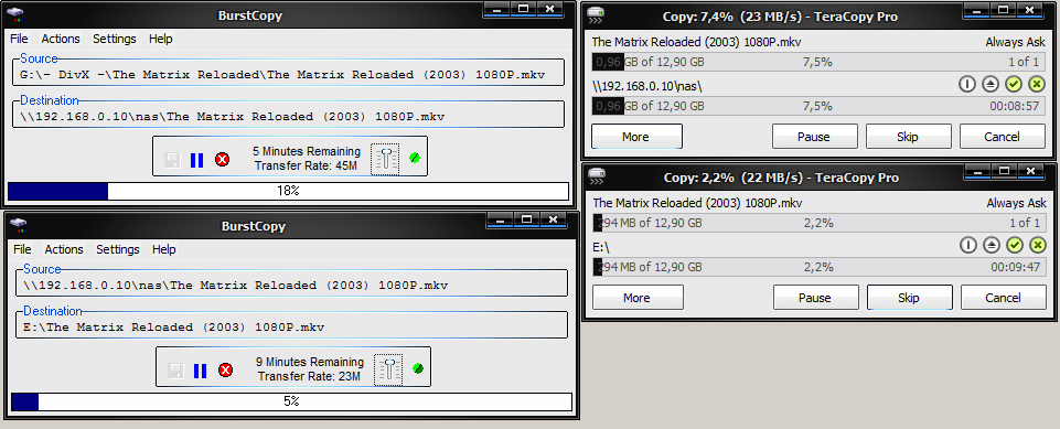

im playing with a test build of unraid beta 5 rc12a with just 2 drives.
everything looks fine till now but when i do real world copy tests it goes weird.
when i copy a big file to unraid i get like 40~50M speeds but when i copy the same file to my pc from unraid read speed is 20ish MB/s
i cant figure out what is wrong. the network is fine cabling and gigabit seems ok, drives are fast enough and almost empty, hardware got no bottleneck all weird...
btw when i use teracopy it reads and writes about same speeds 20ish but burst copy writes 40~50MB/s to unraid. all confusing : )
i was on my way to buy myself some 2tb drives and a licensed unraid then i saw the slow read speed : (

This can be a lot of things, but one very common cause is a cable with an unterminated wire pair.
Try replacing the Ethernet cable.
I'd also try using a different port on your router or switch ... consumer class switches often have defective ports that will cause strange speed issues.
on it now thanks for suggestions
different port different cable same result...
using short cat6 on unraid end now. and changed the pc side port too.
now i will try booting windows on unraid machine and check speeds.
edit
this is weird in windows to windows same results hehe clearly my main pc got somethin goin on... i disabled antivirus/firewall things checked everything can be related to network cant think what can cause this. at least its not unraid related but my pc cant get any faster then 23M  :/ now i have to make another cable to test the pc end too i guess but im too lazy for it now.
anything comes to ur mind other then cabling?
yea ok i jiggled with tcpip settings tried to optimize it for 1 gigabit speeds. its better now sees 37M at peek 27ish other times
is this normal? what is ur reading speeds over gigabit network? what speeds shall i expect?
i send 50ish get 27 in return not cool

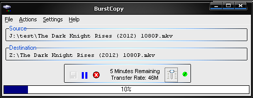

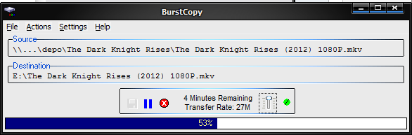

boo i just put 2 ST2000DM001 7200 2tb disks on unraid test server with ssd on pc end; same result
send and receive at 45~50 at best... so somethin is weird here. using on board gigabits. unraid is on intel a weak d510mo mainboard with 2 gb ram, pc using onboard realtek gigabit board from gigabyte. since i dont have much time now i cant play more with it.
