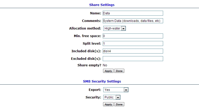

Here are the settings for my Data share. It is disk4 only.
I do not have a cache drive
Since disk4 is the only disk included in the Data share I would expect it to only spin up disk4 and not the others.

You do not need to exclude the other disks => if you list specific disks in the Include, then those are the only ones considered when allocating space for that share.
Note that the Include and Exclude parameters only apply to allocations for WRITING data to the shares.  UnRAID will still check all disks for folders that are part of a specific share.
In other words, if you were to manually create a "Data" folder on a different disk (e.g. Disk 3) and write some files to it;  they would be accessible via the "Data" share.    Because of this behavior, UnRAID needs to spin up any disk(s) it doesn't have current directory info for when you access a share.

Remember what I said:  "Includes" and "Excludes" ONLY apply to choosing where UnRAID can WRITE data for the shares.    They do NOT limit where the shares can actually be if you manually create the folders.  One can debate whether or not this is how it should operate -- but the simple fact is that's how it works.
