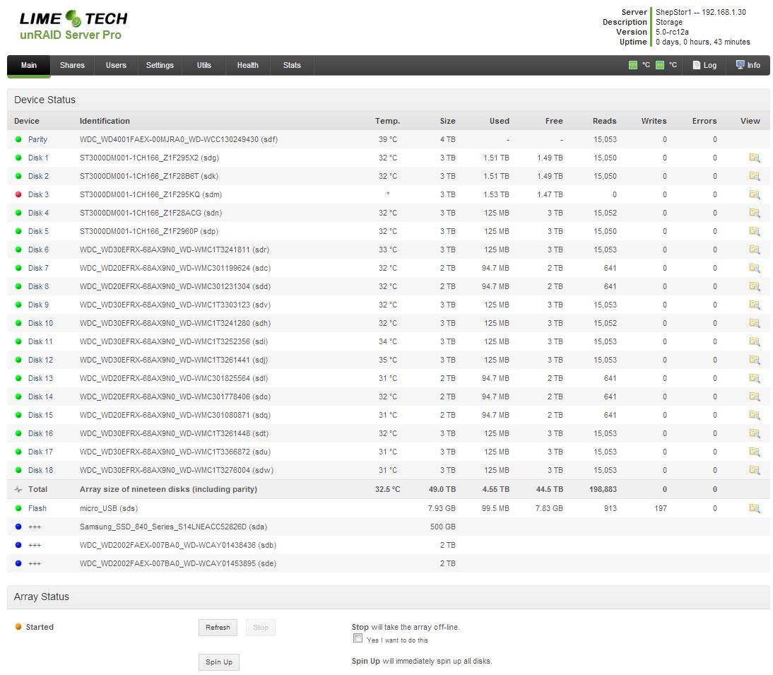

And here's a screenshot of what the array looks like.
From UnRAID's perspective, that's a failed disk (as you know).  You are NOT actually reading from it; or writing to it.  You're reading/writing to the rest of the array, which is emulating the failed disk via the parity computations.
You need to replace the disk -- until you do, you're running "at risk" with no parity protection anywhere else ... lose another disk and you'll lose data.
You MAY be able to just reseat the cables on the disk (disconnect, then reconnect it) ... it may then rebuild it from parity and all will be fine.  If not, you'll need a replacement disk for it.
Alternatively, you could just copy all of the data off of it;  then do a "New Config" and simply not assign that drive to your new config.  The system will then rebuild the parity drive ... and then you'll be ready to go.

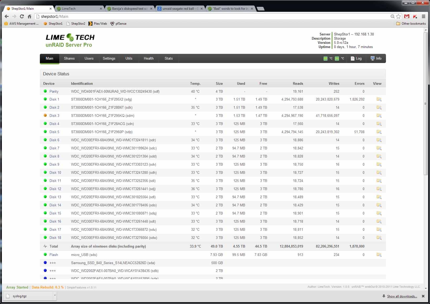

So I stopped the array, removed the disk from the array listing (left it in the drive bay), restarted the array, bam, I reproduced the original issue. 3 different disks went nuts (see pic).
Will post syslog next to see if people see anything. God this is so frustrating. Note that these drives are in different places than the original config, and Reds in their previous spots are fine.
The picture you just posted looks fine.  It shows the drive being rebuilt (current status 0.3%).  What SHOULD happen is that in ~ 10-12 hours it should turn green.  (A bit longer than your parity checks take)
I'd just be patient at this point -- don't use the array; just update the display from time-to-time and track the progress of the rebuild.
I think the screenshot is too large; if you scroll right you see the issue I am talking about.
Attached is the syslog; here is the relevant issue for disk 1.

Jun 15 12:09:03 ShepStor1 kernel: md: disk1 read error, sector=65688
Jun 15 12:09:03 ShepStor1 kernel: Buffer I/O error on device md3, logical block 8211
Jun 15 12:09:03 ShepStor1 kernel: lost page write due to I/O error on md3
Jun 15 12:09:03 ShepStor1 kernel: sd 0:0:10:0: [sdm] Synchronizing SCSI cache
Jun 15 12:09:03 ShepStor1 kernel: sd 0:0:10:0: [sdm]  Result: hostbyte=0x01 driverbyte=0x00
Jun 15 12:09:03 ShepStor1 kernel: mpt2sas0: removing handle(0x0014), sas_addr(0x5001e677b6f5dff2)
Jun 15 12:09:03 ShepStor1 kernel: mpt2sas0: handle(0x0014), ioc_status(0x0022)
Jun 15 12:09:03 ShepStor1 kernel: failure at drivers/scsi/mpt2sas/mpt2sas_transport.c:162/_transport_set_identify()!
Jun 15 12:09:03 ShepStor1 kernel: mpt2sas0: failure at drivers/scsi/mpt2sas/mpt2sas_scsih.c:5194/_scsih_add_device()!
Jun 15 12:09:03 ShepStor1 kernel: md: disk1 read error, sector=4406489400
Jun 15 12:09:03 ShepStor1 kernel: Buffer I/O error on device md1, logical block 550811175
Jun 15 12:09:03 ShepStor1 kernel: lost page write due to I/O error on md1
Jun 15 12:09:06 ShepStor1 kernel: scsi 0:0:17:0: Direct-Access     ATA      ST3000DM001-1CH1 CC24 PQ: 0 ANSI: 6
Jun 15 12:09:06 ShepStor1 kernel: scsi 0:0:17:0: SATA: handle(0x0014), sas_addr(0x5001e677b6f5dff2), phy(18), device_name(0x0000000000000000)
Jun 15 12:09:06 ShepStor1 kernel: scsi 0:0:17:0: SATA: enclosure_logical_id(0x5001e677b6f5dfff), slot(18)
Jun 15 12:09:06 ShepStor1 kernel: scsi 0:0:17:0: atapi(n), ncq(y), asyn_notify(n), smart(y), fua(y), sw_preserve(y)
Jun 15 12:09:06 ShepStor1 kernel: scsi 0:0:17:0: qdepth(32), tagged(1), simple(0), ordered(0), scsi_level(7), cmd_que(1)
Jun 15 12:09:06 ShepStor1 kernel: sd 0:0:17:0: Attached scsi generic sg6 type 0
Jun 15 12:09:06 ShepStor1 kernel: sd 0:0:17:0: [sdx] 5860533168 512-byte logical blocks: (3.00 TB/2.72 TiB)
Jun 15 12:09:06 ShepStor1 kernel: sd 0:0:17:0: [sdx] 4096-byte physical blocks
Jun 15 12:09:06 ShepStor1 kernel: sd 0:0:17:0: [sdx] Write Protect is off
Jun 15 12:09:06 ShepStor1 kernel: sd 0:0:17:0: [sdx] Mode Sense: 7f 00 10 08
Jun 15 12:09:06 ShepStor1 kernel: sd 0:0:17:0: [sdx] Write cache: enabled, read cache: enabled, supports DPO and FUA
Jun 15 12:09:06 ShepStor1 kernel:  sdx: sdx1
Jun 15 12:09:06 ShepStor1 kernel: sd 0:0:17:0: [sdx] Attached SCSI disk
Jun 15 12:09:06 ShepStor1 kernel: sd 0:0:13:0: [sdp] Synchronizing SCSI cache
Jun 15 12:09:06 ShepStor1 kernel: mpt2sas0: log_info(0x31110d01): originator(PL), code(0x11), sub_code(0x0d01)
Jun 15 12:09:06 ShepStor1 kernel: sd 0:0:13:0: [sdp] Unhandled error code
Jun 15 12:09:06 ShepStor1 kernel: sd 0:0:13:0: [sdp]  Result: hostbyte=0x01 driverbyte=0x00
Jun 15 12:09:06 ShepStor1 kernel: sd 0:0:13:0: [sdp] CDB: cdb[0]=0x28: 28 00 00 e4 7c e0 00 04 00 00
Jun 15 12:09:06 ShepStor1 kernel: end_request: I/O error, dev sdp, sector 14974176
Jun 15 12:09:06 ShepStor1 kernel: md: disk1 read error, sector=14974112
Jun 15 12:09:06 ShepStor1 kernel: md: disk5 read error, sector=14974112
syslog.zip
Ah ... yes I see the large error counts for Disk #5.  I have no idea what to suggest at this point.  You COULD wait and see if the rebuild actually completes;  or you could copy all of the data off of Disk 3 (emulated) and then off of Disk 5; and then rebuild the config without either of them.
