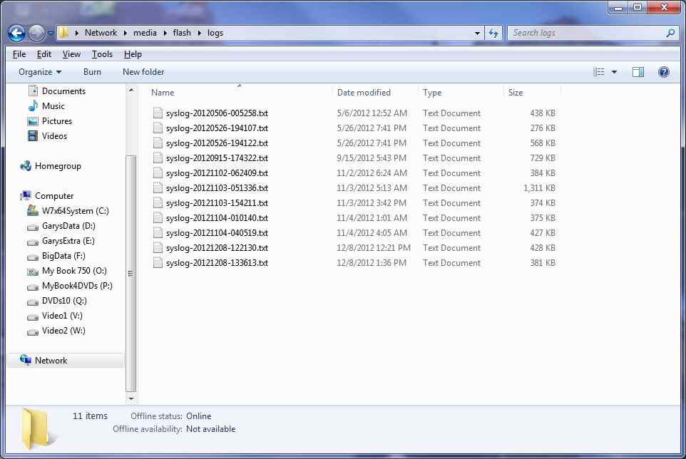

Interesting ... I wonder if the "logs" folder is something UnMenu sets up and maintains.
Since Joe L is monitoring this question, hopefully he'll chime in and confirm whether that's the case ... and also if there's some other way you can access a log without being able to log in to either the Web GUI or the UnRAID console  [i doubt it, but I'm definitely NOT a Linux guy ... so I'll let Joe confirm that  :) ]

unRAID does NOT keep a "logs" directory on the flash drive.
Joe => BOTH my v4.7 system and v5 system have a "logs" folder on the flash drive.  Both are absolutely STOCK systems with NOTHING added to them except UnMenu with the CleanPowerDown and APC UPS packages installed.    I have NEVER added anything else along the way to even "play" with;  nor have I copied any logs to these drives.
So ... where did they come from ???
Looking at the dates of the files, I assume they were written after each successful boot, but your comment that they shouldn't even be there is interesting.    I'll attach the contents of the folders ...
CleanPowerDown package writes log files as part of the shutdown routine.
Ah ha => Mystery solved ... mostly.  Is this an early step in the CleanPowerDown process?  Given that this is how the logs are written, it seems that there are too many of them !!  I'm wondering if it writes the log when power fails ... but before the actual shutdown is initiated ==> so if power is restored at that point there's a new log, but no actual shutdown.

OK, so that is what is saving logs...  An add-on (that many install)
"... that many install ..."  ==> I suspect a BIG understatement.  I'd think that's the most-installed package in UnMenu !!  [Probably roughly tied with the APC UPS package]
