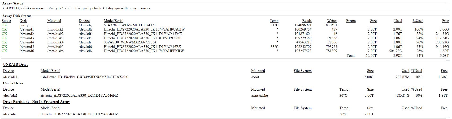

Now with that said, I am seeing quite a few errors on the gui in the row of my parity drive.  Every time there is a parity check the errors seems to go up and I have been blowing it off but am now starting to get concerned.  The gui shows 8603 errors for the Parity Drive row.  There are no errors indicated on any other drive row and the parity check always indicates 0 sync errors.  I would post a screen shot but for some reason I have lost gui ability after running the parity check manually with no corrections today (Parity check usually runs monthly automatically).  I have searched the forum and unable to figure out the issue on my own so hence my post.

Quick glance says your parity drive is failing, and should be replaced now. You are currently at risk of data loss if any of your other drives fails before you get a valid parity drive in place. Make sure you run a parity check after you replace the drive and build parity.
Ideally, you should shut down the machine now, get a new disk to use for parity, and preclear it in another machine to make sure the new drive isn't bad (happens more often than it should) and only then power up your main unraid machine with the new tested drive installed as parity.
If you have backups of all your data like you should, then you can be a little more lazy and just replace the parity disk when you have a chance. If you have no backups, you need to proceed very carefully to avoid data loss.
