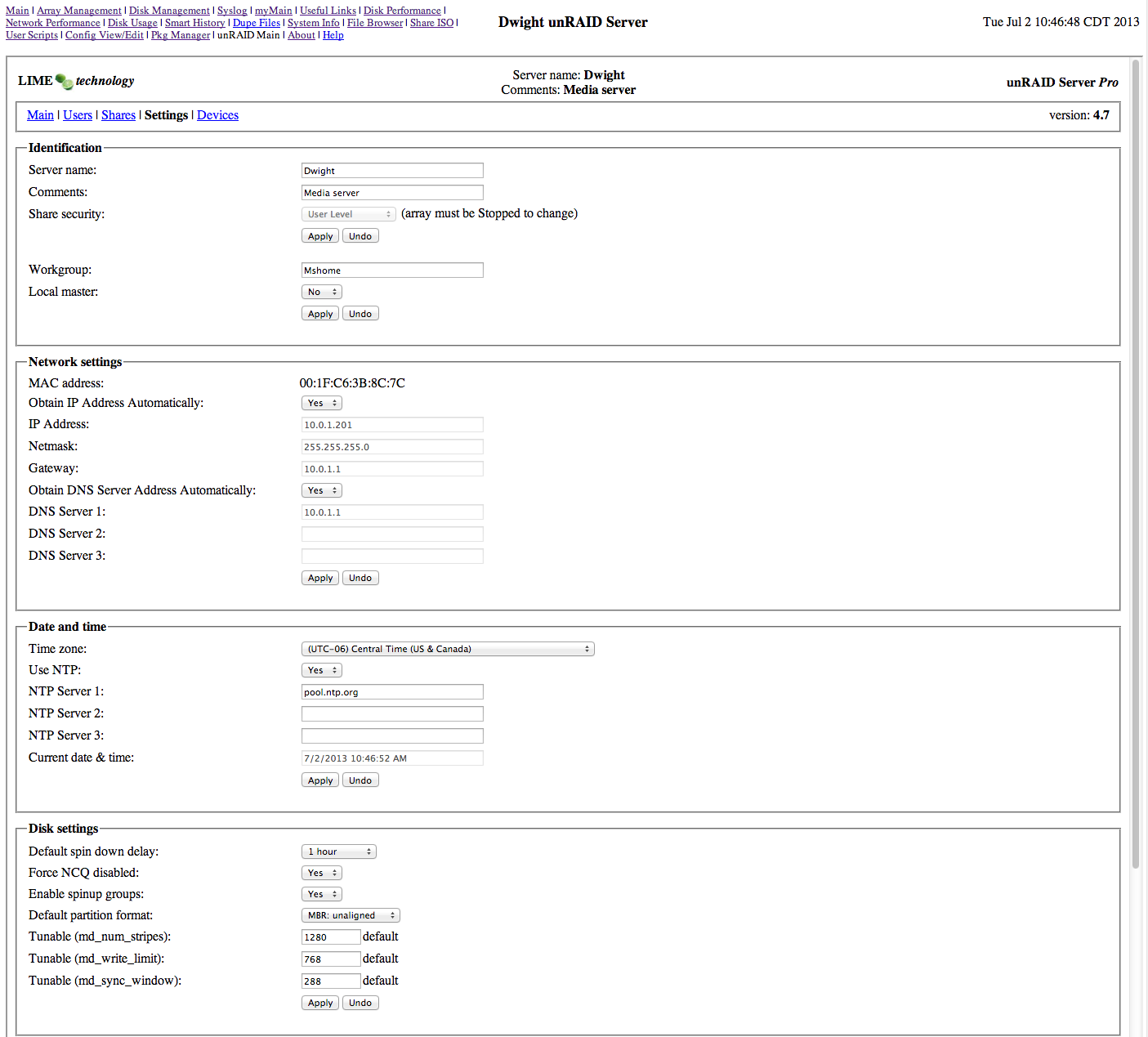

This is an odd one! I think you're going to have to analyze what your different devices IP settings are, paying particular attention to each device's (Default) Gateway address. In unRAID you get the settings from entering "ifconfig" at the command prompt. Your router's address is 10.0.1.1 and that should be the gateway for all your devices.

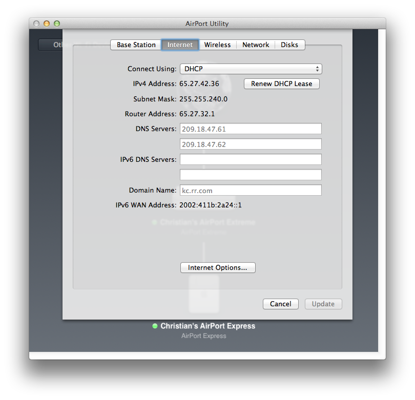

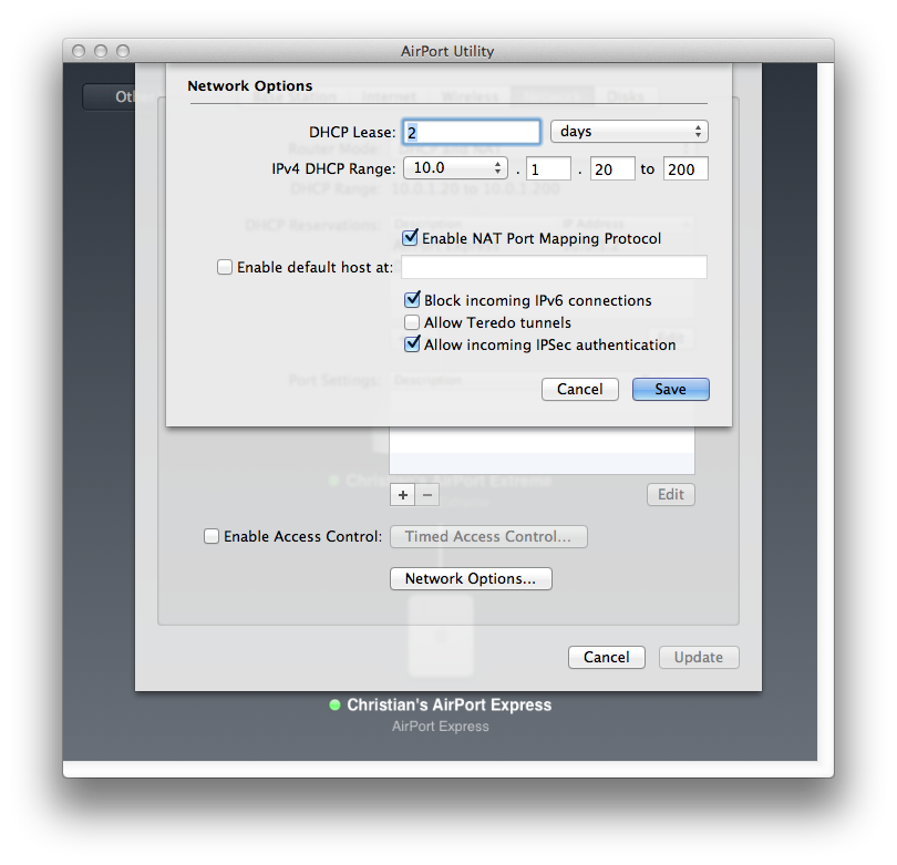

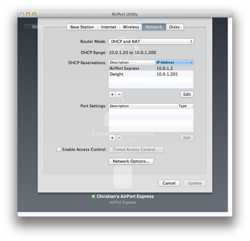

Here are some screenshots of my Airport Extreme settings. Wasn't really sure which ones you would be interested in, so I just snapped some screenshots of the important ones.
Screenshot 2
Screenshot 3
From a glance those settings look ok. I was looking for actual event logs from the router though. Are you using the latest firmware for the AirPort Extreme?

Could you post your workstation's IP settings? Maybe it's easier to  post a screen shot from the network section of your settings showing IP address, Subnet Mask and Default Gateway. Those are really the key things to know when troubleshooting network connectivity.
Here's a screenshot of my network settings.
Thanks for the screen shot of unRAID. Can you send one for your workstation, the computer you are using now? Thanks!

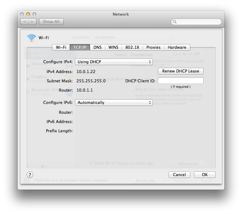

My iMac currently connects over WiFi to my Airport Extreme. Same network connectivity issue occurs over ethernet as well when the server shuts down. Here are the network settings I think you're looking for from my iMac.

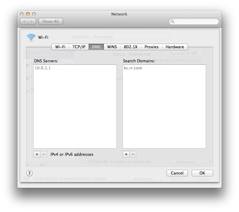

The workstation shot looks good; I can't see a problem with your settings. The gateway address is that of your router and that should work. The next problem area might be the DNS settings. Could you screen shot that tab or just post what your DNS is set for?

Here's a screenshot of my DNS settings. And as for the Network Utility app, I've never used it before, but I'm familiar with Ping and such so I'm sure I could follow some directions. Thanks for all the help...I really appreciate it!!!

Thanks for sending the screen shots. Here again, I don't see a problem.
