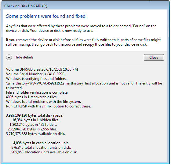

Have you ran chkdsk on your usb drive?

in one file, "first allocation unit is not valid"
go ahead and run chkdsk again with the fix option?
Yes, better to fix it but corruption on that smarthistory file is surely not the cause of the problems you are getting...

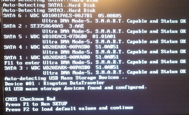

Shut it down at night. Booted in the morning and got "CMOS checksum bad." I hit F2 to continue and it continued to boot.
I ran a memtest for 6 hours. zero errors. Rebooted again and got the CMOS checksum bad error again.
This is new. Never saw a CMOS checksum error until today. Change the battery?
I'd change the battery.  The last system I saw this on the BIOS eventually became wholly corrupt, only spewing gibberish on the screen (it looked like a normal bios boot - text in the right places, mostly, but a lot of the characters were extended ASCII nonsense).  Once it was that corrupt it wouldn't get past the bios to boot the computer.  Hopefully it's just the battery in your case.
