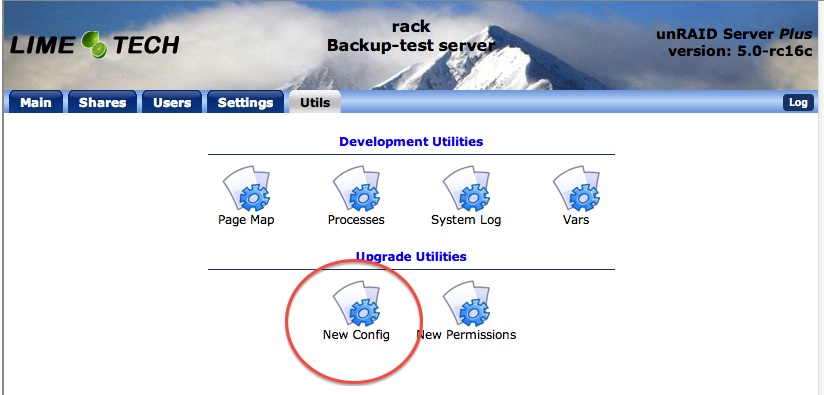

July 23, 201313 yr Under the Utils tab on the unRAID webGUI. Repeatedly set a new config using a subset of the disks. Each iteration will require that parity is built and then checked. It should take at most 3 trials to isolate a bad data disk. If it's the parity drive it may take an additional iteration.
July 23, 201313 yr Author Goggling 'unraid New Config Utility' returns very different results than 'unraid New Config' - I promise I was not being purposefully daft on this point. Just to confirm my understanding - this will kill the parity drive then rebuild the parity information when I start the array to the parity drive (with hopefully no data loss). Repeat these steps 3 or 4 times. What should I look for at the conclusion of each run? http://lime-technology.com/wiki/index.php/FAQ ******** OR do you mean that I should say forget about saving the data and: run1 = parity + md2 + md3 +md4 ...if an issue, likely the parity drive problem ...if not an issue run 2: run2 = md1 (as parity) + md2 + md3 +md4 ...if an issue, likely the md1 drive problem what would runs 3 and 4 be? ******** OR something else entirely? Thanks again!
July 23, 201313 yr Parity is already corrupt. The data on 3 data disks is good. One of the data disks may be corrupt. Or the parity disk may be bad. Once the bad disk is determined if it's a data disk the contents of the drive will have to be copied to a new disk. A windows recovery tool may help. Always assign the parity drive as parity or you will lose data. Set a New Config (see image attached) Assign parity, disk1 and disk2. Start the array and build parity. Check parity. If there a are zero errors then the issue is with disk 3 or 4. Set a New Config. This run will have parity and either disk1 or disk3 assigned depending on the previous result. If all trials result in errors then try with a new parity disk
