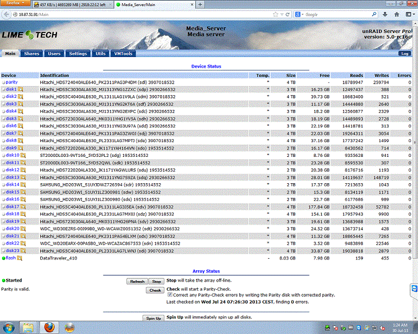

The problem is: Unraid says the drive has 178 Gb free. But when I try to copy something to it, the copy hangs at around 177 Gb. It just crashes with a timeout

I do use the disk share. I use win7 and copy from my SABdownloader to , in this case, disk17/bluray. I don't have a cache disk.
It always gives a timeout at around 177 Gb free (I manually 'refresh' unraids main window every few seconds to see when it happens).
I though it is some filesystem corruption. Maybe I deleted some files and the filesystem thinks those blocks are still in use? But a reiserfsck can't find any problems.
I don't know what else to do, so any help is appreciated...
Below is a screenshot of the main window.
