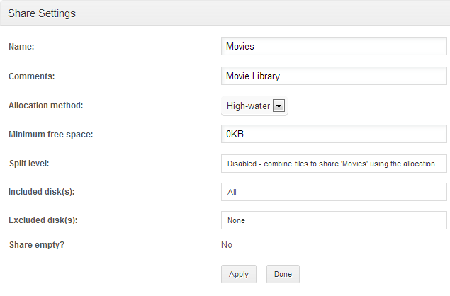

So I have high water set as allocation method and disabled split level... I don't have folder/files to separate as I only have files.

With high-water allocation it should have started writing to the 2nd drive when the 1st was half full.
Did you enable shares (on the Settings menu) and create a share for your data?
... and are you writing to that share?
If you simply created a folder on disk1, and are writing to that folder, UnRAID will simply write it to that folder.
Yes, I did enable shares in settings and created a shared folder. I told it to use all drives. I disabled split level... yesterday but high-water allocation was set from the beginning.
Thanks again.
Post screen shots of Settings->Share Settings and the Share config page.
Attached.
What path are you typing/using when writing to the share?
/mnt/user/Movies
