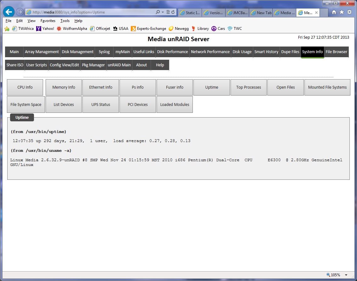

I certainly agree v5 seems very stable so far -- I've got one server on v4.7 and one on v5.0, plus a couple test units on v5.0 that I frequently reload and do various tests on (trying to replicate issues folks report here).
However, there is one thing I like about v4.7 with regards to stability =>  if emhttp (the Web GUI) stops responding, you can restart it with a few simple command line entries on v4.7, but cannot do that on v5.0 (it tends to generate segfaults).
Nevertheless, I'll probably update my v4.7 to 5.0 the next time it shuts down due to an extended power failure.    Meanwhile, it's so reliable I'm not inclined to do so  :)
