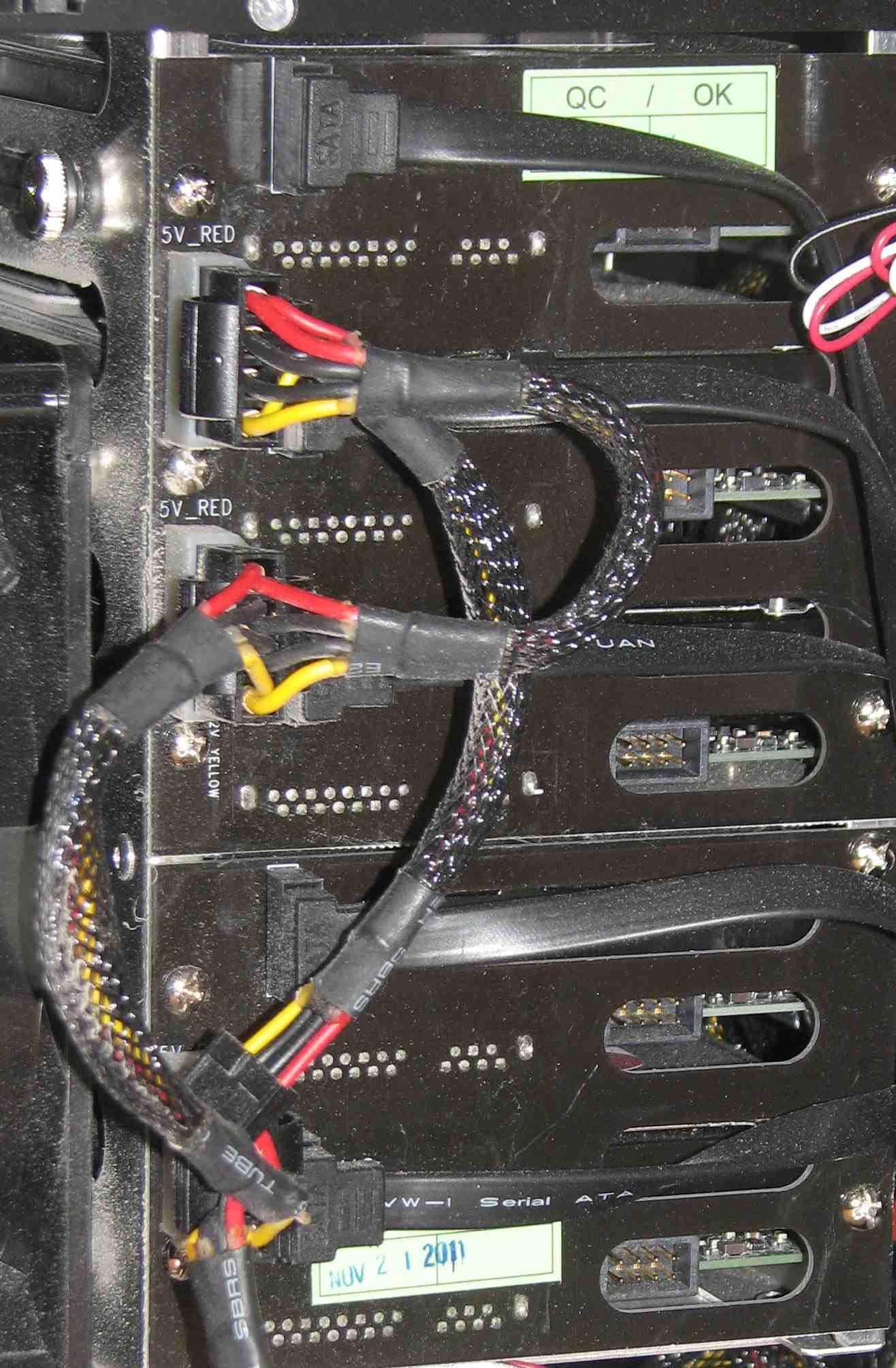

I tried a longer right angle cable I had and it works fine on both ends, o/c on the backplane the higher ones cover the lower ones but they don't cover the power connections.

Gary, not for nothing, but could you take a picture of the backplane of yours that needed left angle sata cables? No hurry but I was trying to figure out why they were neccessary. Are the sata ports vertical?
Yes, the SATA connectors are vertical, and facing the wrong way for a standard right-angle connector.  I'll take a picture later and post it later.
The same site that sells the left-hand cables also has standard right-angle cables in lengths as short as 4", so you can get the lengths you need to make things as neat as possible -- 4", 6", 8", 10", 12", 14", etc.

Here's a picture that shows the Left-Hand SATA connections.

Right, but not with right angle on both ends. Unless I am missing something they are pretty rare in short lengths, and the 10" ones will work fine. Well, we''ll see, the ones I ordered should be in soon.
Thanks for the picture. You just might have a rare prototype that will be worth a fortune someday, after you finish making these builds a household item.
Edited to add picture of the backplane we have been seeing lately, and is probably what you should expect to receive>>>
Yes, I've seen the newer version of the backplane.    I've built about 6 systems with the Q25B ... the first two had the backplanes like mine does (requiring left-hand cables);  the rest had the (I assume) newer version of the backplane.
Actually, the version that requires left-hand cables allowed for a "neater" running of the cables, since they are "headed in the right direction" (towards the motherboard) after they're plugged in.  The hassle was finding left-hand cables  :)

It's much better to use angled cables on the backplane.    I THINK (but am not certain) that they're only shipping the versions like Qtrmeg has that work fine with right-angled SATA cables;  but if by chance you get one that needs the left-hand cables, there's no problem with that => just buy them from the link I provided earlier.

You definately want a right angle cable off those 4 ports on the edge of the MB. I tried both straight and angle cables and being right next to the drive cage the bend is too much with straight ends. The 5th cable you need to fill the drive cage needs a straight end to the MB, so the backplane end of that cable could be left.
Anyhow, there was a question about using straight ends on the backplane. Ya, no problem. You have over 1 1/2" to the side cover >>>

Yes, it definitely looks like you have to use right-angle connectors on that motherboard.    As long as your backplane also supports right-angle connectors, there's no problem finding right-angle to right-angle SATA connections.
But IF you should happen to get one of the backplanes that need left-angle SATA connections, you're not out of luck !!  :)      Except for the fact they're longer than you need (but it's easier to wrap extra length than it is to use the wrong angles), here is a source for a left-angle to right-angle cable:
