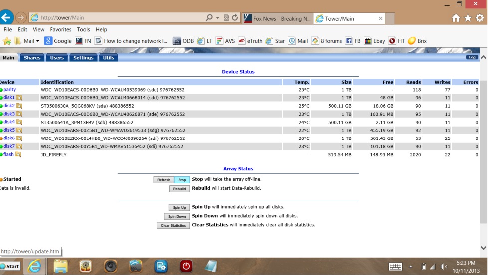

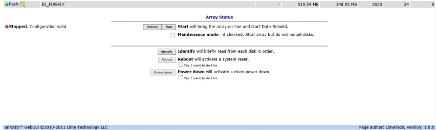

Here are two screen shots of the system started, and stopped. I don't see any way to format the disk. I am trying to replace a failed (slot 6) 500 GB drive with a 1TB drive.
Additional info: unMenu installed; Simple features deleated; Air video installed; JRC installed
On the 'Started' screenshot I can see the Rebuild button that needs pressing to start the rebuild of the disk.  I think you are getting confused by thinking there should be a Format option.
So, my understanding is that after starting the array I then click on the Rebuild button to first clear, then format, and finally rebuild the contents of the failed drive. This seams easy enough. I just need a little information on what this is all about. I will do some more searching.
I was confused about the function of the Rebuild button. Reading the ver. 5 user manual on wiki, I could find no reference to this button. Under the Replace a failed disk heading I found this, "When you Start the array after replacing a failed disk, the system will reconstruct the contents of the failed disk onto the new disk; and, if the new disk is bigger, expand the file system." From this, I was expecting this to be done automatically. When I could not detect any activity my mind went back to ver 4.7 and  the Format button. I have also tried to find some reference to this button in the forum. It is probably there but my mind tired after a while.
