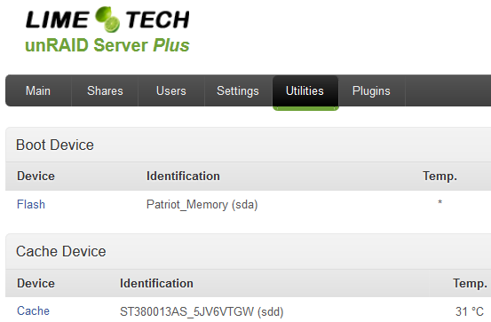

October 16, 201313 yr Author Are you using the new webGUI by any chance? I noticed that right after V5.0-final was released and wound up going back to the old default page and it's back to normal. I'm using whatever the stock v5.0 GUI is, to my knowledge. See attached screenshot.
October 16, 201313 yr Author That is not the stock 5.0 GUI. It is the new (experimental) web GUI. Okay, so it's a bug with the experimental GUI. How do I revert to the "Standard" GUI?
October 16, 201313 yr Check these URLs: https://github.com/limetech/webGui http://lime-technology.com/forum/index.php?topic=28839.0 They should provide you with enough info to remove the plg file from your USB drive.
October 16, 201313 yr Author Check these URLs: https://github.com/limetech/webGui http://lime-technology.com/forum/index.php?topic=28839.0 They should provide you with enough info to remove the plg file from your USB drive. Thanks for the links. I've bookmarked them in case I need them in the future. I don't want to remove the GUI, I like how it looks, I just wanted to report a bug.
October 16, 201313 yr Thanks for the links. I've bookmarked them in case I need them in the future. I don't want to remove the GUI, I like how it looks, I just wanted to report a bug. Go here and click "New Issue".
