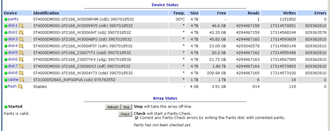

I removed 6 x 3 TB drives from my array, re-init array and re-assigned drives.  Started array and it started parity check.  Ran for a few mins just fine and I came back an hour or so to check on the status.  Main status window shows huge read/write/error numbers.  Main status also says that parity is valid.  It is not.  I need to recalculate the parity.  All data on all 8 x 4 TB drives is valid and present.

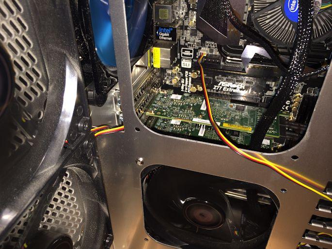

One thing I did notice is that the LSI controllers were getting HOT.  Just in the short amount of time that I did the firmware/bios upgrade.  Afterwards, I powered off and ensured the cards were seated.  They felt hot.  So, I moved a 120mm fan so it blows directly down on the two controllers.  I've got good airflow in the case but I think they may have needed a little more help.  I'm wondering if this could have been the problem all along.  However, I just moved 18 TB of data so you would think they would have overheated during those transfers.

it could not have been seated properly the whole time.
Well, at one time I removed the controllers, verified no debris in PCIe slots, no damage to card edges, etc.  I've checked / wiggled to ensure they have been seated several times... and each time they have.  That was one of my initial concerns.
