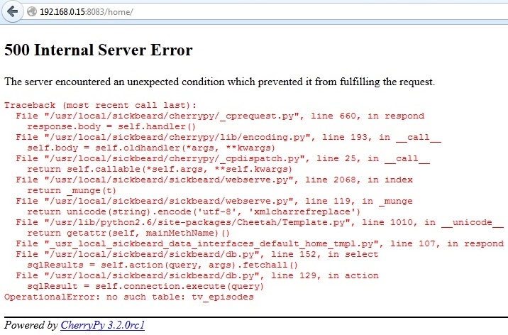

When first installed sickbeard, i configured it and everything ran fine. I added existing shows which sickbeard found no problem. Even restarted (stopped array then powered down) and all the configurations remained. It seems though that over night something happens and I get an error in the morning (attached). All the configurations are reset to default and none of my shows are shown anymore. I once again configure everything and get it going again. Sickbeard runs fine all day, but once again the next morning I get the same error.

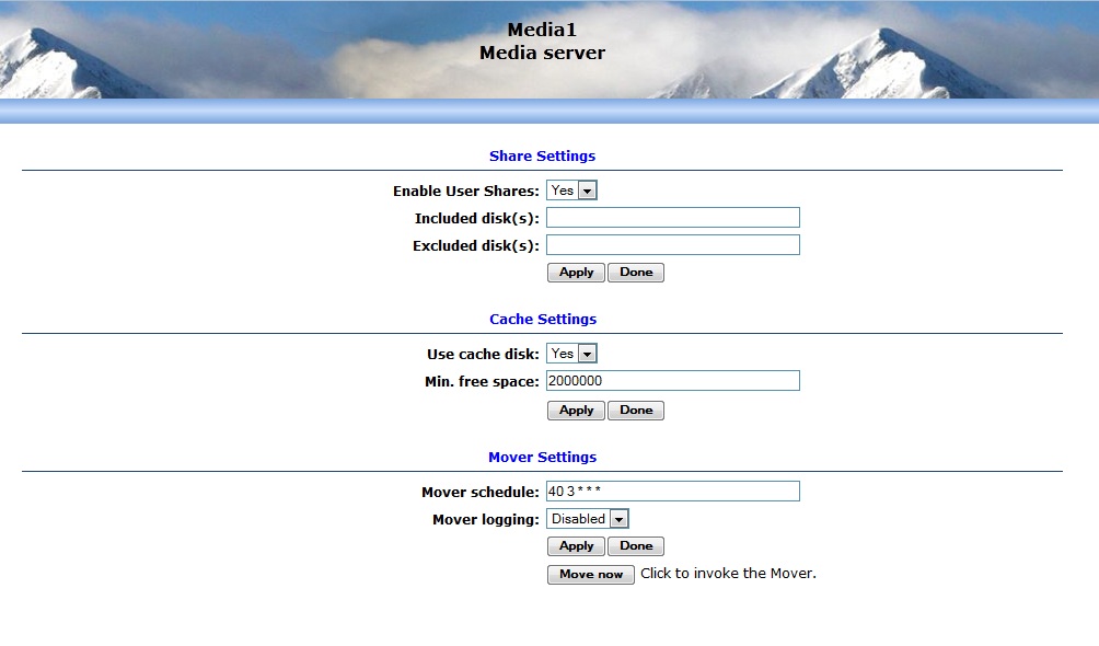

Sounds like the mover is moving the files to the array. Do you have the share as cache only?

Thanks for the reply! Mover was enabled under share settings. I disabled it and will see what happens tonight. Thanks!

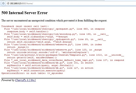

I disabled the mover last night, but still had the same issues this morning. Had an error in sickbeard and couchpotato showed a blank screen in the browser.
I have attached some of my settings and the error from sb this morning. I have no idea whats going on...
