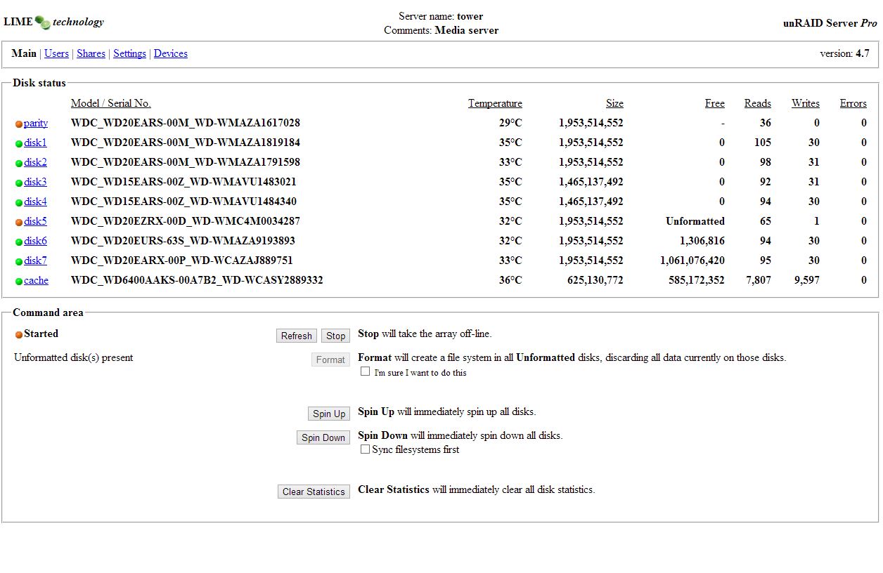

I'm guessing one of my disks failed? Parity disk= invalid & data disk =disk_dsbl
Version 4.7
Noticed my server hanging up one day and restarted it. When it came back online I noticed that there was an orange dot for the parity, and red for disk 5. In umenu, the parity disk shows up as invalid and disk 5 shows up as disk_dsbl. I'm guessing disk 5 is kaput and needs to be swapped out? I've attached the log below

Ok I tried to add 2 drives at once, and I get the error:
"Stopped. Invalid configuration. Too many wrong and/or missing disks!"
I also see the old drive in italicized font underneath the new parity drive. I can assign the data disk and parity drives but I can't do anything with the array. So i tried disconnecting the new parity drive, and hooking the old one back up. I have an orange orb next to the old parity drive and the new disk 5 data drive. I tell it to format the unformated drive (disk 5) but then it doesn't do anything and im stuck on this screen with the attached picture below

NOT the right thing to do unless you've given up on reconstructing your failed drive #5.  IF your plan is to give up on a reconstruction (since you don't have good parity to do this with), and you simply try to copy what you can from the old, failed, disk;  then you need to do a NEW CONFIG and set the drives as you want -- THEN it will start fine and do a new parity sync.
If, however, you want to try to force the bad parity to be used anyway to reconstruct disk 5 (which I do not recommend; but that's what Fireball3 suggested and you implied you might want to do);  then what you need to do is a New Config with all the original assignments -- checking the "Parity is Good" box; and then IMMEDIATELY stop the parity check that starts when you Start the array.    Then Stop the array;  unassign disk5;  Start the array (so it shows as missing); and then Stop the array and assign a new disk to the disk5 slot; and then Start the array again ... it will now do a rebuild onto the new disk5.    I DO NOT recommend this process ... you'll end up with a "known bad" disk5 => and since you don't have backups to compare it against, I'm not sure what you gain from it.
I'd just do what I had suggested -- do a New Config with both a new disk5 and a new parity drive;  let the new parity sync be computed;  and then, with a known-good array, just copy whatever data you can read from the old disk to the good array.

Ok I do want to just scrap Disk 5 and the Parity Drive, but I'm unsure about how to go about starting a new configuration. Do I physically replace both drives at once? Before starting the new configuration?
