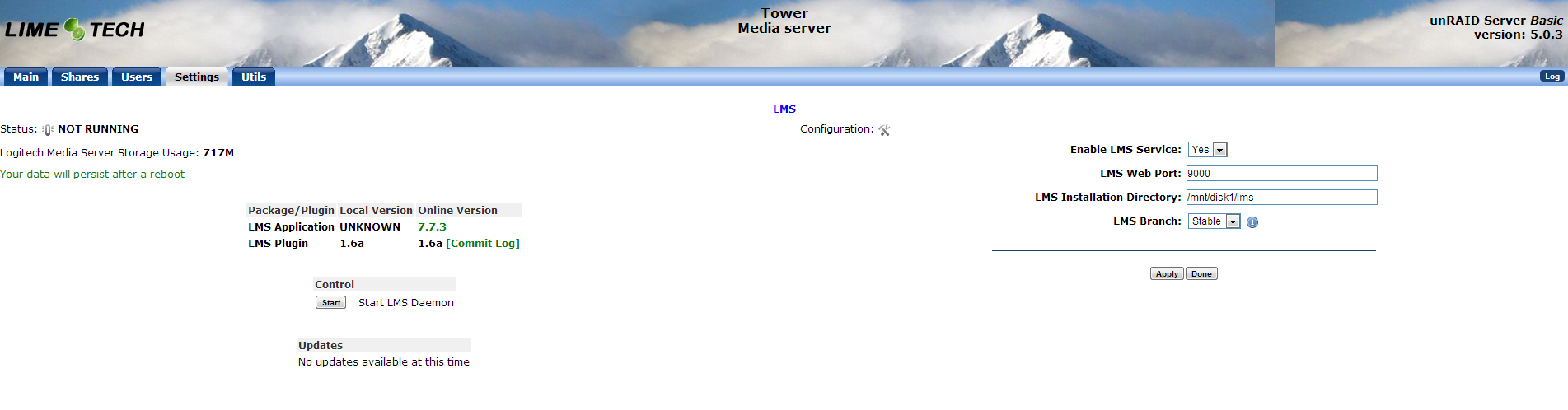

Request for help - Unable to start Logitech Media Server
Let me know if I should be asking for help under another discussion topic.
I've been unable to start LMS for many months, today I re-approached the issue by upgrading from rc.5 to 5.0.3.
During the upgrade I removed the /config/plugins folder from my flash drive. Once I verified that the server would boot up and run without a problem, I downloaded lms_overbyrn.plg and moved it to a new folder on my flash; /config/plugins.
After restarting the server, I found the LMS info screen was available, through the WEb gui, under settings (see screenshot). Enabling the LMS Service seemed to run successfully but, starting the LMS Daemon fails.
I suspect the root cause will be a previous LMS install from over a year ago, I may need to locate and remove the remains of that install.
Any ideas would be appreciated, I have 2 squeezebox radios I would like to use with Unraid.

markiii / icelake, I've just tried the lms_overbyrn.plg plugin here on a fresh v5.0 system and it's installed and started fine.  My first suggestion would be to perform the installation and startup all from command line where you'll get to see if anything funky is happening.
Assuming you can afford to start off with a system that doesn't have LMS installed at all, then try doing something like this;
1. remove the lms_overbyrn.plg from the plugins dir and reboot
2. put the lms_overbyrn.plg file back into plugins dir
3. fire up a command line and install the plugin using "installplg /boot/config/plugins/lms_overbyrn.plg"
4. watch what it does and note any issues along the way.  It should however install the plugin without issue.  At this point LMS itself is not yet downloaded or installed.
5. Go to LMS plugin settings page and configure your location, port etc.
6. Do NOT press "Install" button and do NOT set the service to enable.  Just change the location, port and branch and hit apply.
7. Back at command line, issue the following command; "/etc/rc.d/rc.lms buttonstart"
8. Again note down what it's doing and pay attention to any red flags.  The output should look like this;
