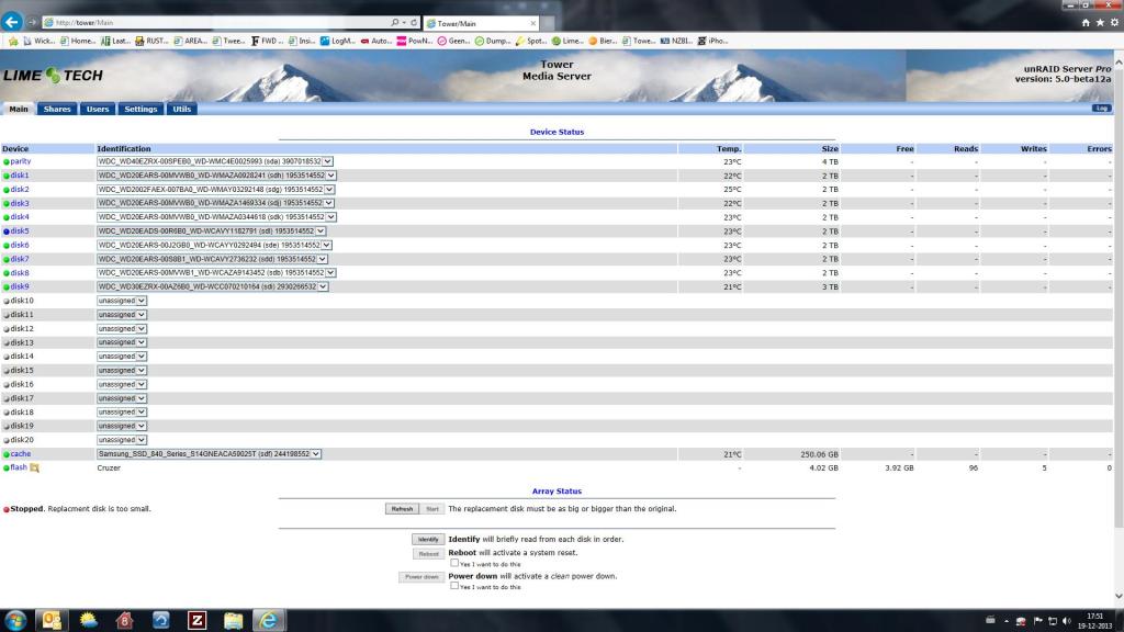

So, what is shown exactly on the main web page right now? Post a screen shot.

Hi Guys,
I reinserted disk 5 (picture 1) which gave a blue ball.

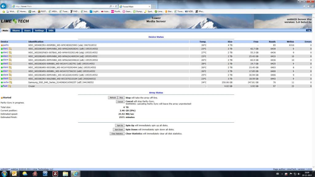

Then I started the "New Config" utility, re-assigned all disks and started the array.
Parity started to build automatically (picture 2),  now I'm waiting for it to be finished.
All data on disk 5 is still there, in the right shares, so I guess I can mark this post solved!
I will later first start a non correcting parity check, and after that install my pre-cleared my 3TB disk.
I'm sure everything will work just fine.
Thank you for all the help and suggestions!
