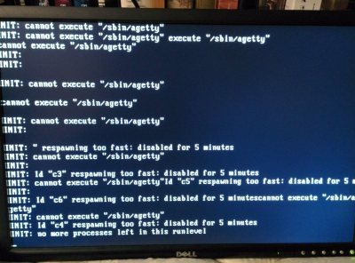

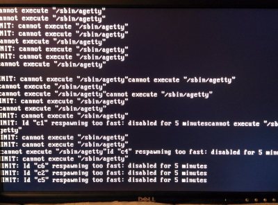

*Finally* managed to find the time to install the vidcard and try this again!
The boot process seems to go through fine until it hits a section that says:
INIT: cannot execute "/sbin/agetty"
INIT: Id "cx" respawnig too fast: disabled for 5 minutes
Then it does seem to wait the 5 minutes, and then goes through the iteration again. Attached are a couple of screenshots.
Any clues?
