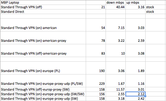

I did some initial speed testing myself with a few different variations. Unfortunately this was through a macbook pro and I wasnt able to test on my main rig. But i dont think this will influence the results too much. I dont have any screen shots from my router.
Im running tomato on the Asus RT-N12
1) Difference between a US server and a server in Sweden
2) 3 combinations - vpn only, proxy only, vpn and proxy
More to come

Just did a basic speed test using speedtest.com, not the best i know but i was tight on time and wanted a rough idea.
For future testing i can change the method if it will yield better results. i know speedtest.com sometimes gives weird results cause ISPs speed up the connection to make it look more favourable. I hit 120 mbps once running to the server near my house without vpn. load of shit definitely as im on a 35 mbps package (if i said that wrong before my bad, just checked the bill to make sure)
