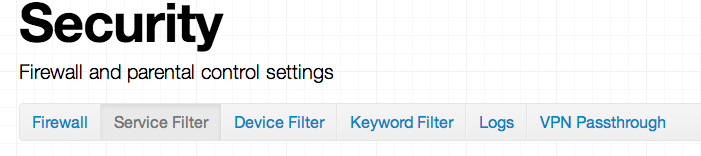

so i got it all to work up until blocking the ports on my main router so that vpn ports are only open. I have a rogers modem/ router and i cant find the option anywhere.

What is the brand/model number of the rogers modem/router?  You may be limited in what you can do on the cable ISP modems/routers.  They don't offer a lot of features.  If you upgrade your VPN router you can use the RT-N12 as your main router and place the rogers device in bridge mode.
For the rogers, may be called IP filtering in the firewall section.
no such option
here are the security options
