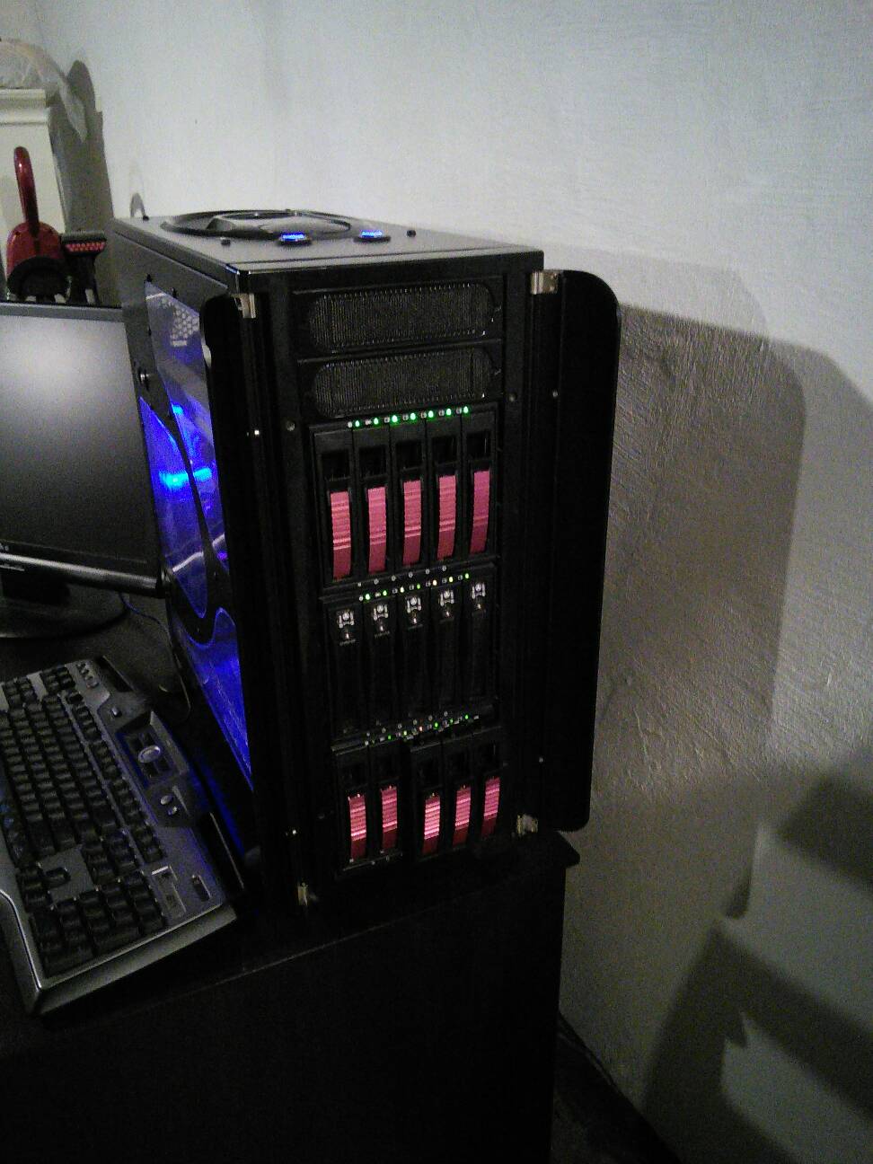

total of 27TB of storage spanned over 13 drives  plus cache and parity (15drives total) all in three 3x5 istar hotswap bays
My basement workstation.

I wonder which solution fixed it for you.  Be a shame if you couldn't turn on the hot swap and use those nice bays you have there like they where intended.
