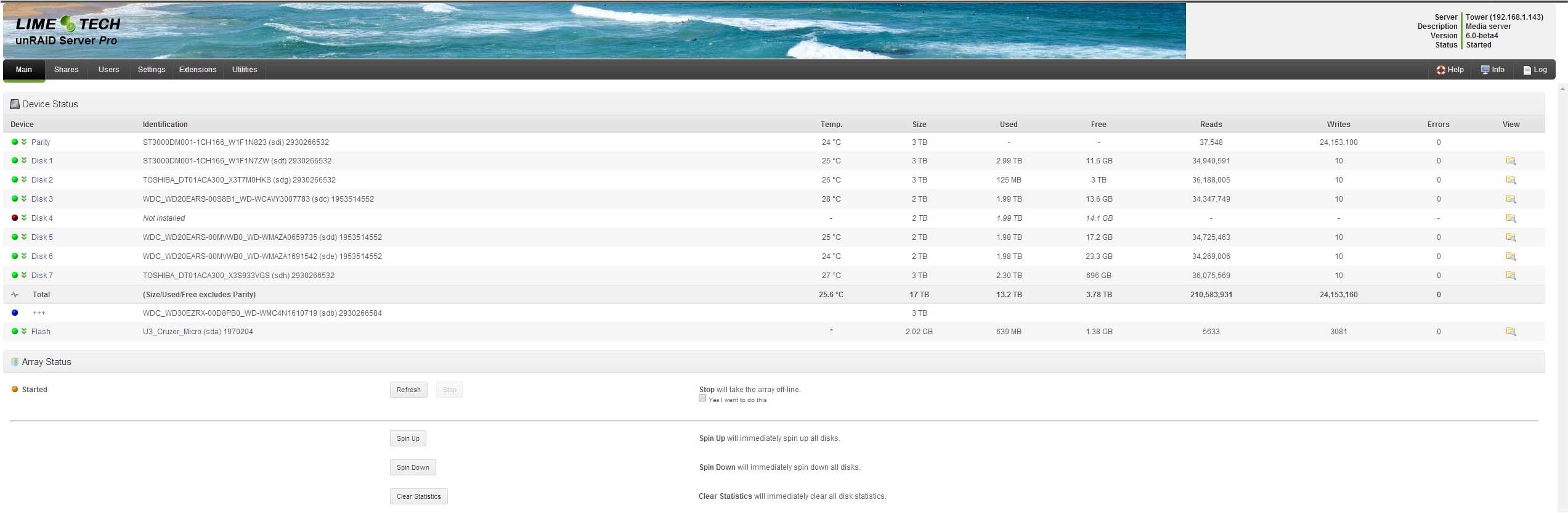

Please see the attached screenshot of my UnRAID main menu.  Let me know if you need anything else!  Thank you so much for taking a look at this for me.
Assign and rebuild disk 4.
The rebuild of Disk 4 completed in just under 8 hours, and everything appears to be good!  I tested files and everything seems to be okay.  The drive has a nice green ball next to it and it's accessible within UnRAID GUI and Windows Explorer.  It shows a large number of writes to Disk 4 in the GUI as well, so it appears to have rebuilt completely.
