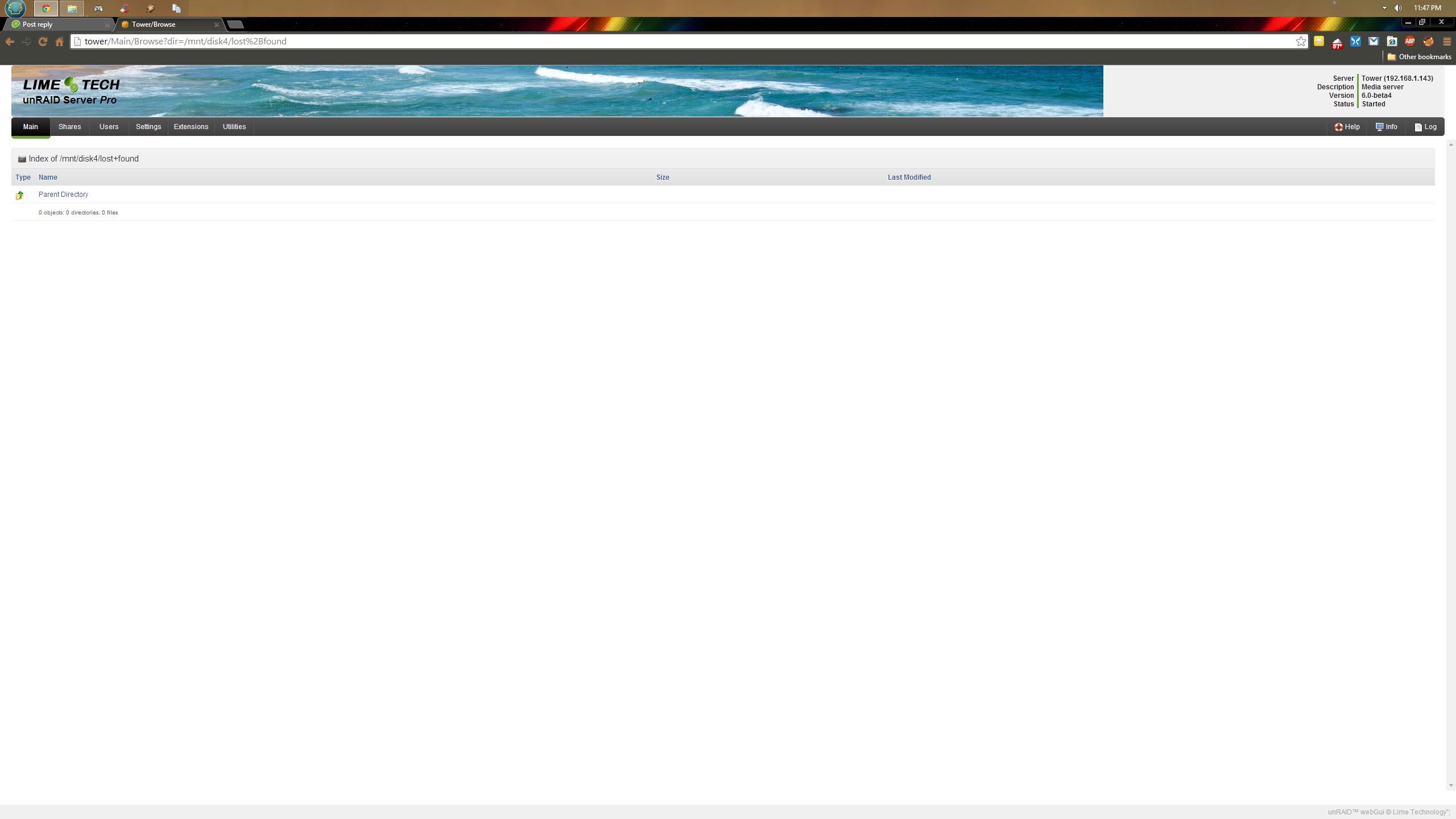

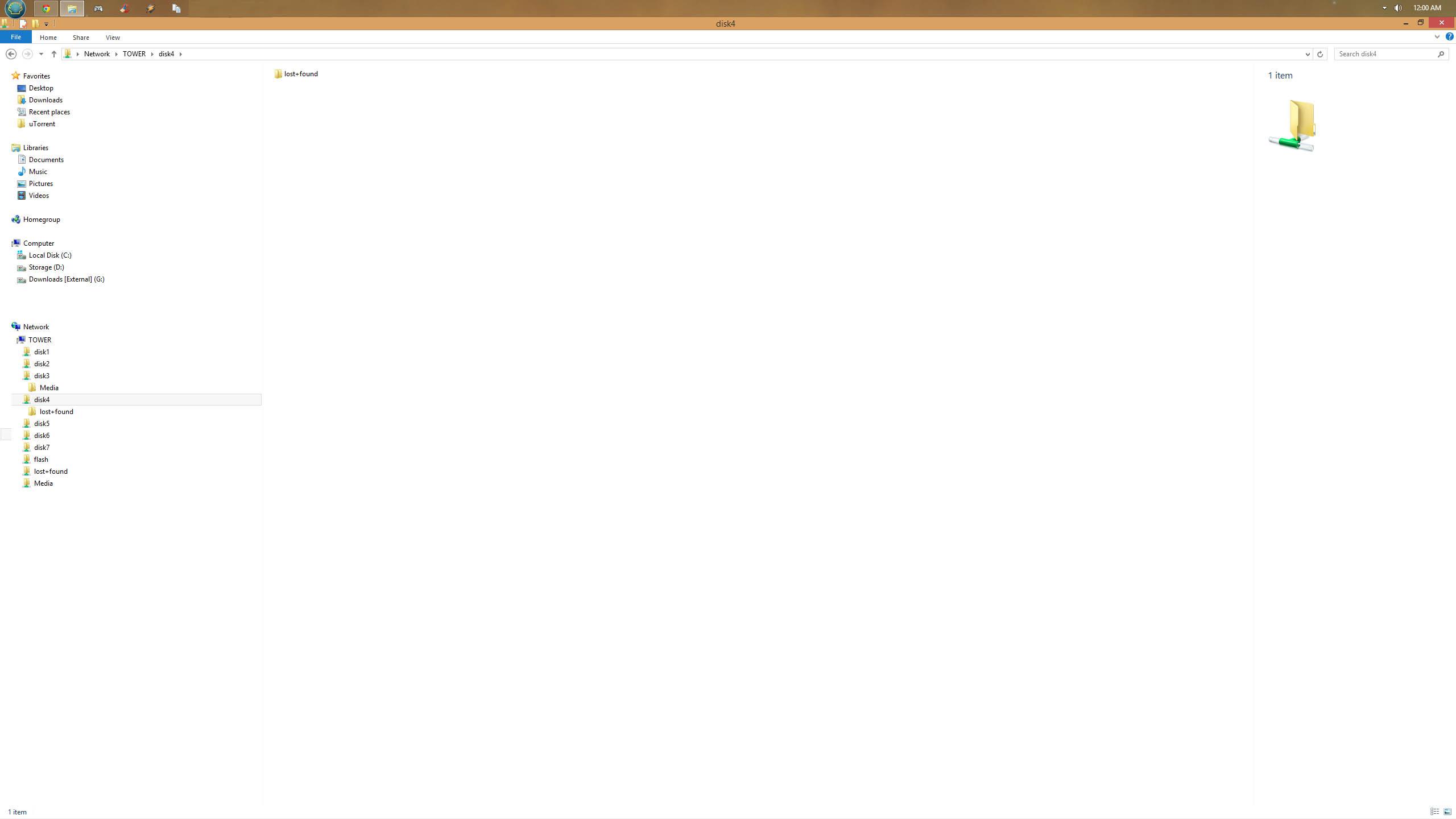

Wow, I feel stupid as it was because I had the array in maintenance mode (which does not mount disks).
Anyway, I navigated to Disk 4 in Windows Explorer and it looks like it has one "lost+found" directory, and it is completely empty.  From what I can tell, all of Disk 4 is empty after completing the "reiserfsck --rebuild-tree --scan-whole-partition" on MD4.  The entire file tree structure is also gone, which I have attached an image of the UnRAID GUI to illustrate this.
I'm not sure what this means, but it does not seem good as I'm assuming it should reflect the results of the "reiserfsck --rebuild-tree --scan-whole-partition" I ran on the backup image.  I am assuming I will also need to do some more intensive recovery, but I will again wait to see what the experts here suggest as you've all been so helpful!
What about the rest of disk4? What is NOT inside the "Lost and Found" folder?
The "Lost and Found" folder is actually the only folder on the entire disk.  I used to have a share on the disk called "Media" with a number of sub-folders inside it, but now it's strictly only this "Lost and Found" folder at the root of the disk.  I've attached another image to illustrate it in Explorer.  UnRAID GUI is also stating that Disk 4 has 94.7 MB Used and 2TB Free, so it sounds like it's empty  :-\
OK, that is unexpected, but since the data has been recovered, not worth persuing. Mount the image file that you created in unRAID and copy the data to an array disk.
