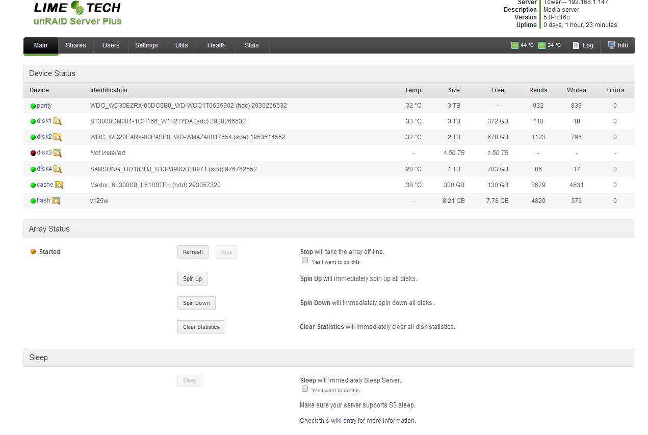

Do you have a parity drive? Is drive3 the failing drive? Is the array running now without drive3 assigned?
/mnt/user is the mount point for the user shares, and not the user shares themselves. Not sure what unRAID would do with the files if you copied them to /mnt/user. Did you copy them or did you move them?
If you have parity then you should still be able to access the files. They would be simulated by using parity and the other drives to reconstruct the data. If you haven't messed things up then you should be able to rebuild to a new disk or maybe even to the old disk if we can determine that it is OK.

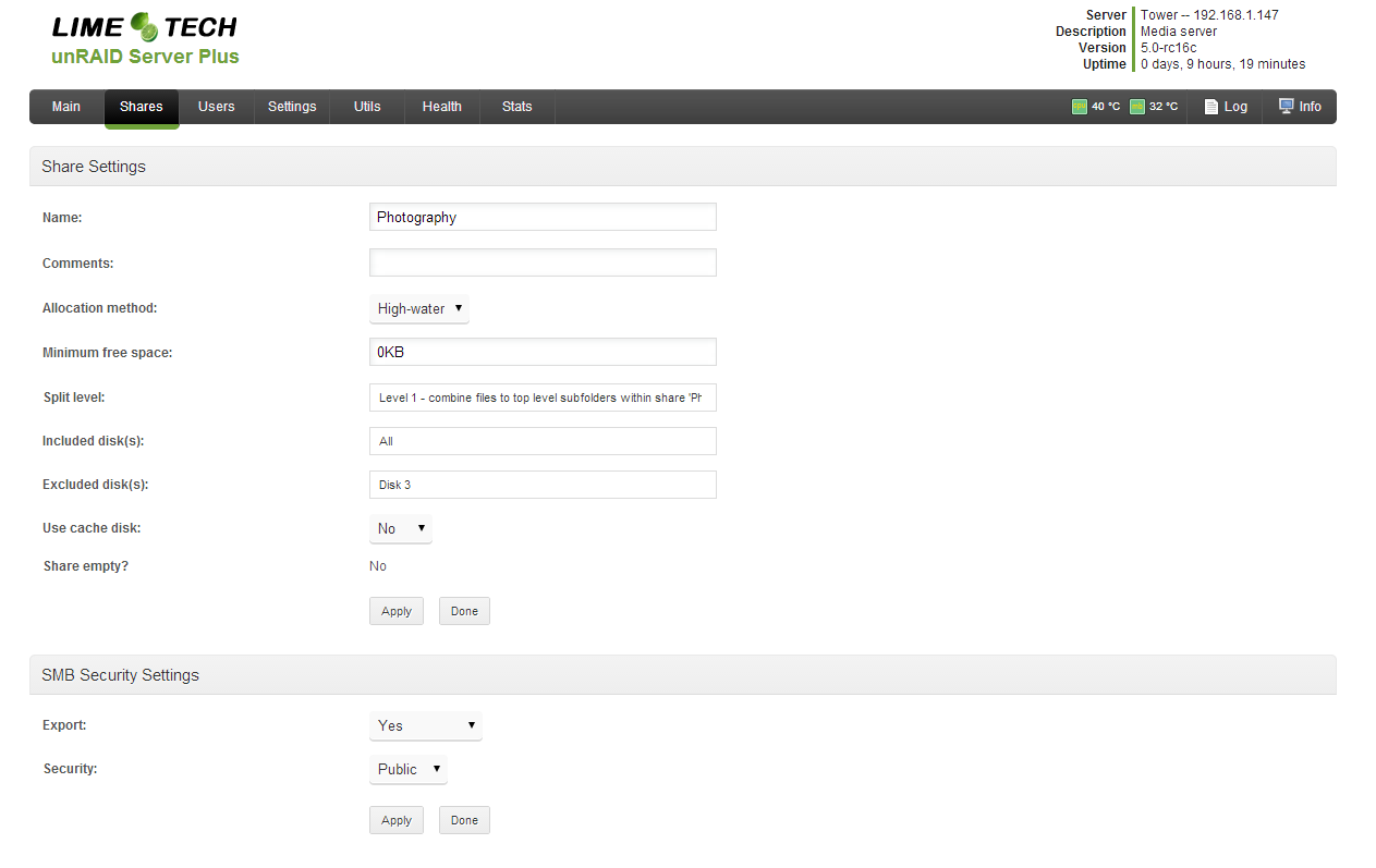

1. I excluded Disk 3 from all of my shares.
2. Used MC to copy the folders from /mnt/disk3 to /mnt/user

I don't really understand that wiki article. It would make sense if you had enough room to copy them all to cache, and it would make sense to copy them to /mnt/user if you first set all user shares to exclude disk3, but it doesn't seem like it would really do anything if disk3 was still a possible destination for the copy which it would be if disk3 was still included in the user shares.

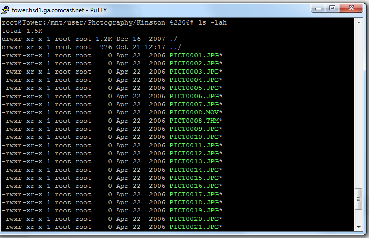

What are you seeing that makes you say that they are all zero bytes? What do you get with
ls -al /mnt/user
You should still be able to access the (simulated) data on drive 3 even though it is not assigned. Can you still see the files on disk3 in mc?
When I access /mnt/user I still see all the folders and files listed however when I go into any folder that I copied from /mnt/disk3 the files are all 0 bytes in size.

If you want help you need to post a lot of details about what you did and whAt you've done to try and fix the problem. 2 or 3 sentence posts are not going to cut it. To get you started ...
1. What were the symptoms leading you to believe disk3 was bad? Posting a picture of the unRaid management page would help. Smart report would also be helpful.

Copying files from a disk share to a user share in effect causes the file to try and overwrite itself - thus resulting in the 0 byte files that you see.  You should have copied the files to another disk share to avoid this.

Not exactly sure what is meant by this??  I excluded disk 3 from all user shares

Here is another screen shot of some 0 byte files
The red ball is a beautiful thing for you at this point.
What that means is unRaid kicked the drive out of the array and went into a mode where it simulated disk3. So any updates made to disk 3 were made to the simulated disk and not to the real disk.
If you mount the real drive 3 in the cache slot, it should be available at /mnt/cache, or over the network as //tower/cache.
If all you say is true, that disk should be exactly the way if was before it red balled.
It is possible the drive really failed, but red balls are more typical of loose cables then drive failures.

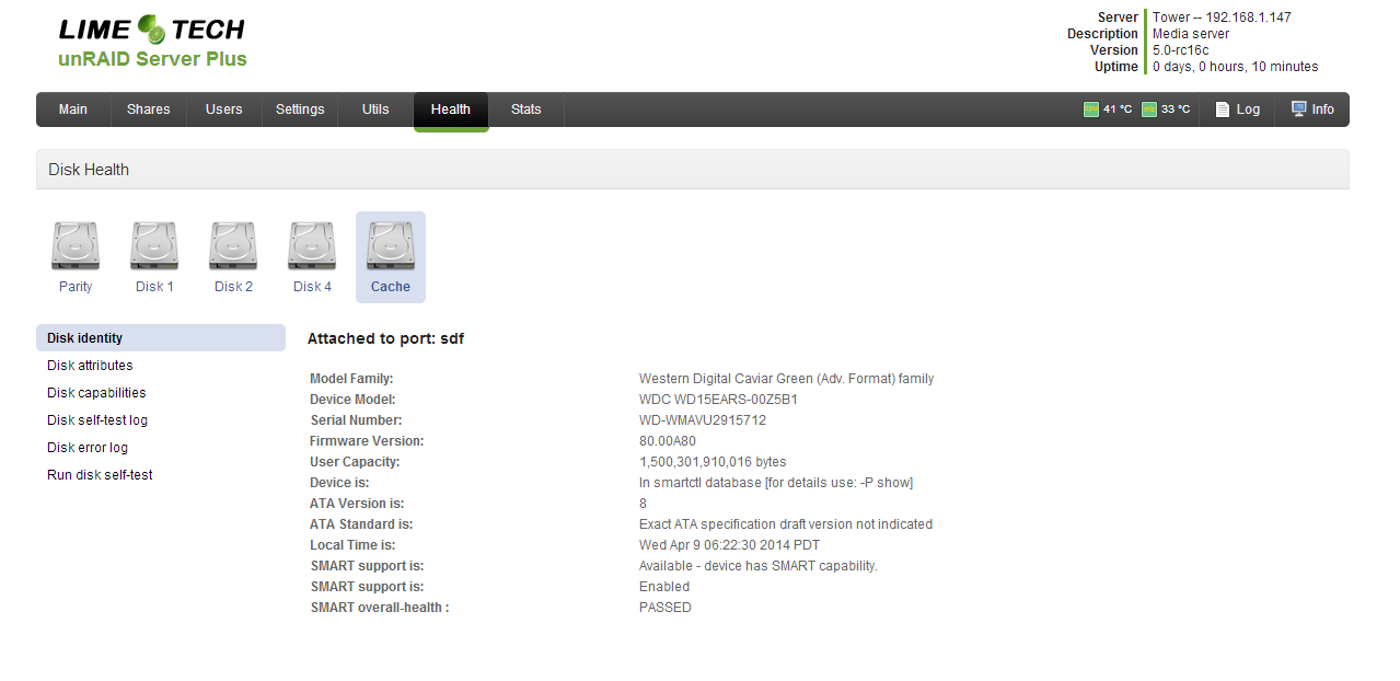

Update: Can someone confirm maintenance mode disables the mover script? If not elm, hold off. We need to disable it before starting the array with disk3 in the cache slot.
Hey Turns out the drive itself isn't bad.  It was a bad SATA cable all along.
1. Changed the SATA Cable
2. Assigned the drive to the cache drive just in case.
3. Moved data from the drive to another disk
Thanks for all the help, and sorry about the panic!
