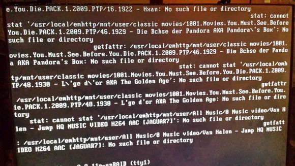

cannot STAT
A question to someone more knowledgeable on linux naming conventions:
Could this be a problem with 'spaces' in the user share names?
'mnt/user/classic movies' instead of 'mnt/user/classic_movies'?
'mnt/user/All Music' instead of 'mnt/user/All_Music'?
The path is wrong. /usr/local/emhttp/mnt... does not exist. It should be /mnt/user...
Looks like /usr/local/emhttp/mnt is a link to /mnt. Are you trying to access the files through the web interface maybe?

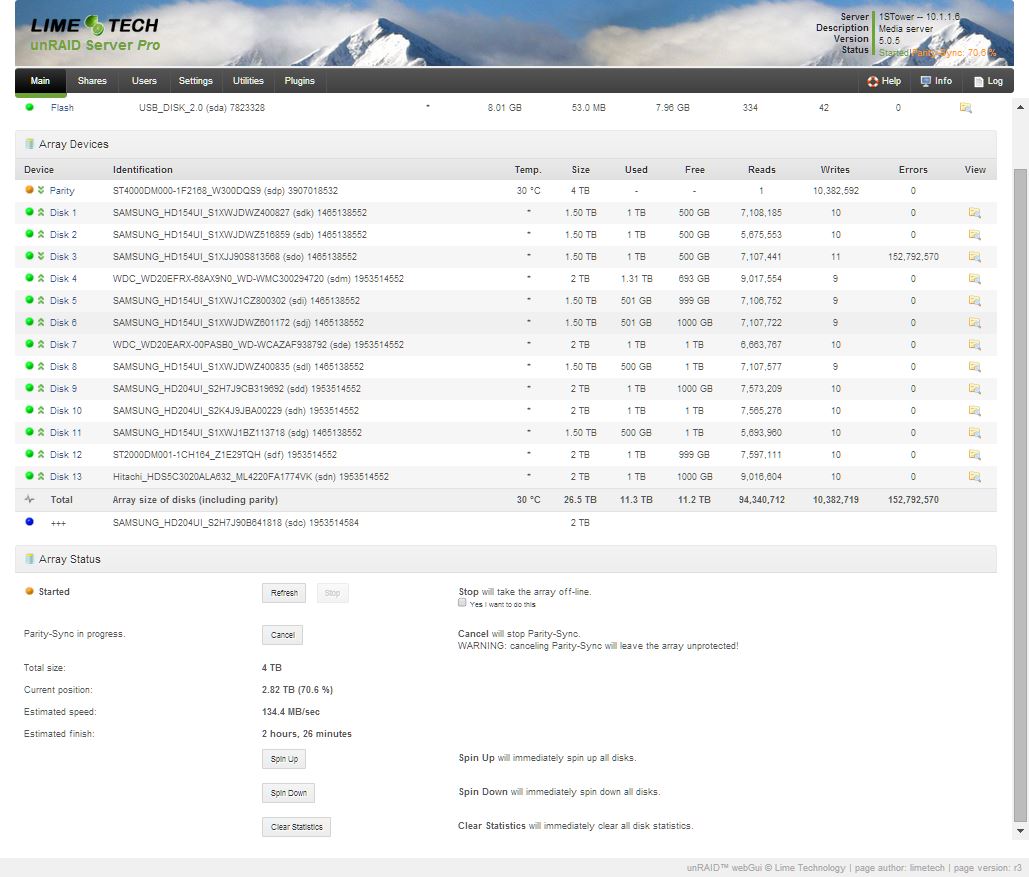

I believe I clicked on the internet "http://1stower/Main" and noticed it was doing a parity check 5-7% thru.
I wanted to know that if any drives had dropped out or failed so I rebooted & drive 3 was missing completely,
so I added my spare for a rebuild. then after that was completed & ok I did a prarity check.

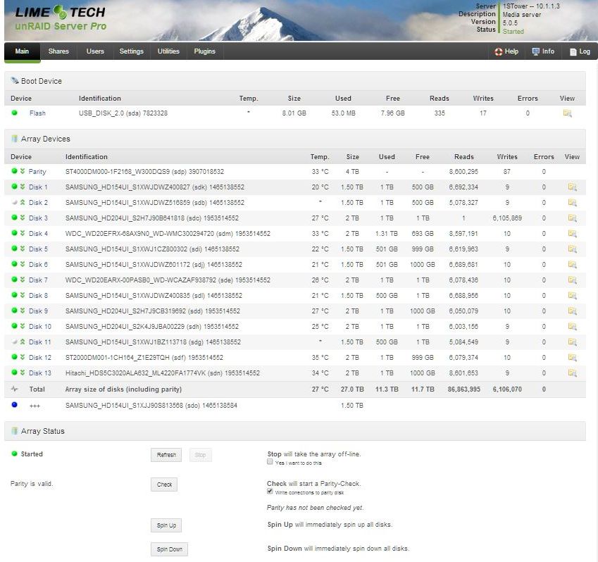

this what it was after I replace disk 3,
I have swapped back disk 3 for the spare & doing a new config now.

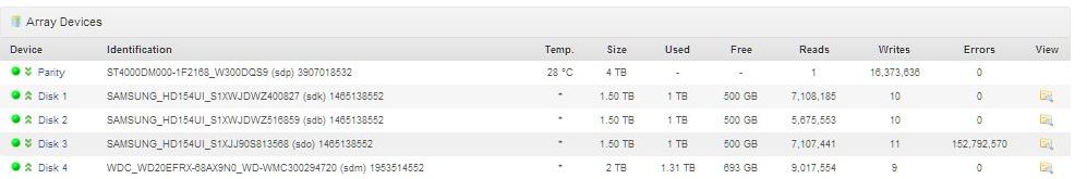

update after trying to rebuild the original disk 3 1.5tb.
there was 152K errors then after a finish & a refresh no disk3.

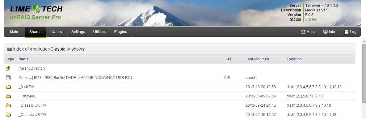

this folder is 20gb but unraid is saying its 0b.
I have a few files on the server like this.
I appear to be able to read & copy them but they do come up as stat see early screen pic

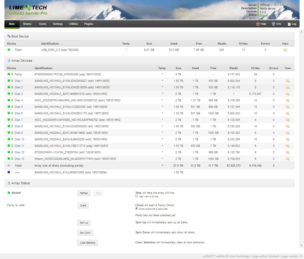

i have run a parity check with both drives & with the rebulit 2tb it is still unset or
saying 0b for some files
I have just rebooted & here it is
