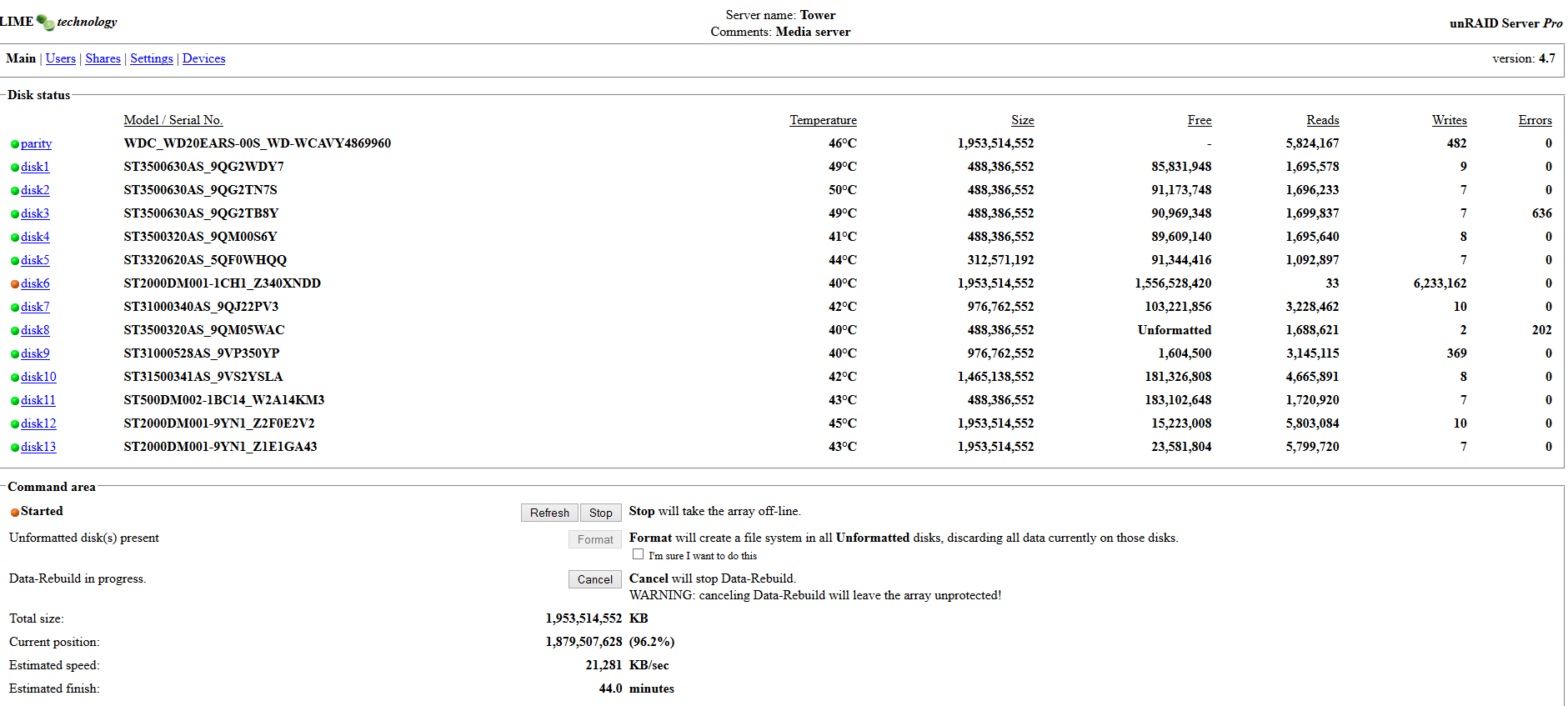

Greetings.  Its been awhile since I dropped by but I have a question.
I've had unRAID for years.  My box is running ver 4.7.  Its a tower I bought directly from limetech.    Has 14 drives in it ranging from 320GB to 2TB.  I've lost a drive a couple years or so, replaced it and rebuilt no problem.  A couple days ago I noticed a drive had given errors and died.  It was a 500GB drive and I replaced it with a 2TB drive yesterday.  It was drive number 6.  I booted, the array started and began doing a data rebuild.  All drives were green other then drive 6 that was being rebuilt.  Meanwhile I had access to the array and things seemed fine.  It told me it would be 3-4 days till it was done.
Now its been a bit less then a day since I  put the new drive in.  I lost all contact with the server.  After checking that it was not my computer I finally hooked a monitor upto the unRaid box and got no signal.  So I hit the reset switch.  It was slow to come back up but it did.  All drives other then number 6 are green and it says a rebuild is in progress.  It looks like it started over.  If that was all I saw I'd be happy.
However.... It also says drive 8 is unformatted,  it did not say this yesterday.  Yesterday it was fine.  But, the reads are going up on all drives including 8 while the writes on 6 are counting up.  So it looks like a data rebuild might be in progress.  But how is that possible if there was error with drive 8 and its unformatted.  Drive 8 was fine this morning.  I had checked the status a couple hours before I lost contact with the server and all was good.  My shares seem to work.  But if I goto \\tower I can't see the default \disk8 share.  Its missing.  Ironicly I do see \disk6 and its the one I replaced that I hope is rebuilding.  It does report 31 errors on drive 8.  this number is not changing.  Just the read count is changing.
What are your thoughts?  Have I just lost a bunch of data?  Do you think it will straiten itself out?  Should I do anything.  I'm leaving it alone for now.
See the attachment for a screen shot of what I'm seeing.
Cal.

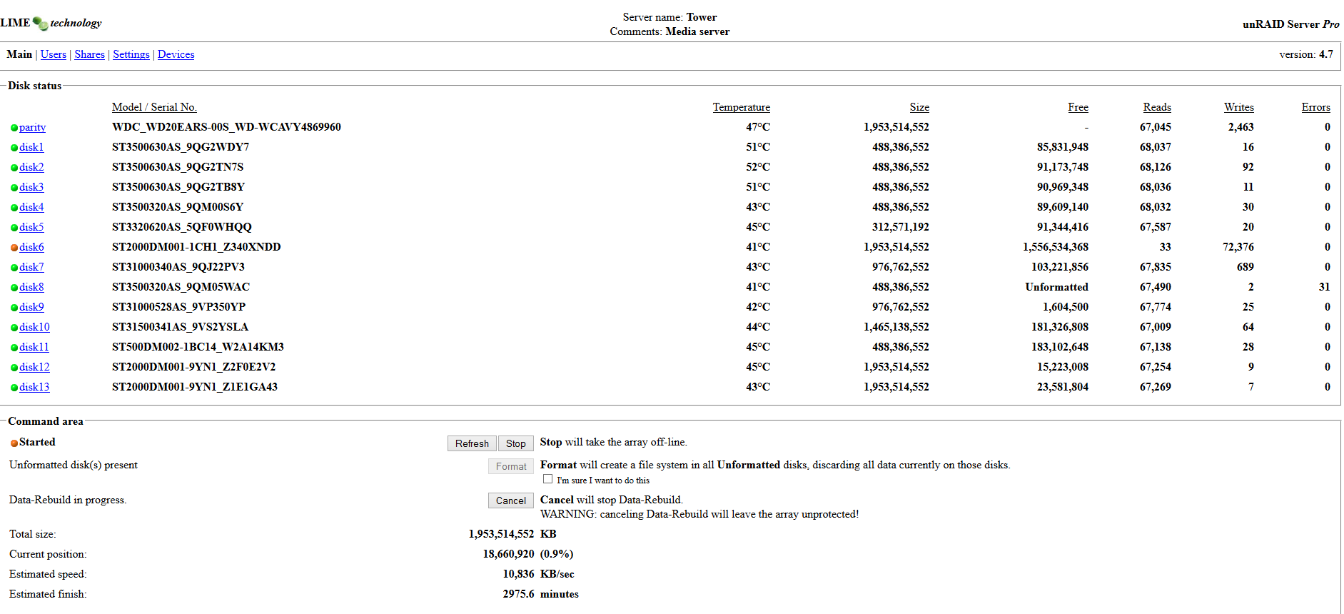

Hm.  Not good.  Went for supper and came back..  Server was dead again, no responce.  Rebooted it.  Its restarted the refresh.  Same disk8 still says unformatted.
Zip and attach a syslog. Drive 8 is having read errors. This may impact some files on drive 6 but the rebuild should eventually complete. Don't worry about disk 8 until the rebuild is complete.

The syslog is showing read errors for disk3 as well. Attach another screenshot.
Yes.  I noticed the errors.  It has not been 3 days but its down to 44 min till its done.  These errors did not show the first time.
And its done.  Tried a few random movies from Disk6 and they play.  But they still could be corrupt.  Nor do I know if anything is missing.  But I suppose that's a good sign.
Checking data shows about 378 GB of used space.  It was originally a 500Gb drive so that's likely correct.  Now I guess I need to get drive8 back and see why drive3 had errors.

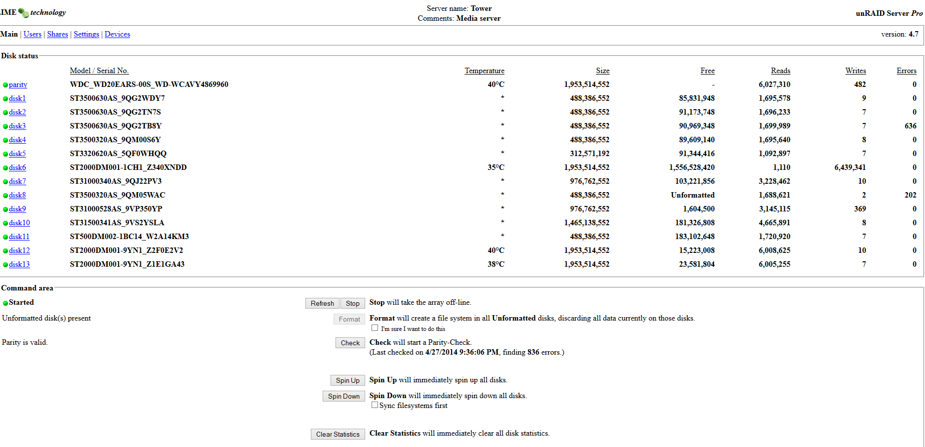

I've booted twice tonight and both times the array came up as good.  No errors on either drive 3 or 8 tonight.
Here is a smart of 3 and 8 as well as a current syslog.
I'm thinking 3 and 8 had issues.  smart remapped the bad sectors and they are no longer in use.  But thats just me guessing based on not seeing any issues.  How do I properly determine if I have an issue?  What plans did you have for me once I have a new drive to play with?
smart_and_syslog.zip
Both disk 3 and disk 8 are showing pending re-allocated sectors which is not good (albeit not fatal).    If pre-clear does not set these back to zero then the drives are not usable in unRAID.
Both the drives also have re-allocated sectors.  This in itself is not an issue as that is what the spare sectors are there for, but it becomes an issue if the number keeps rising rather than remaining stable as that can be a sign of pending failure.

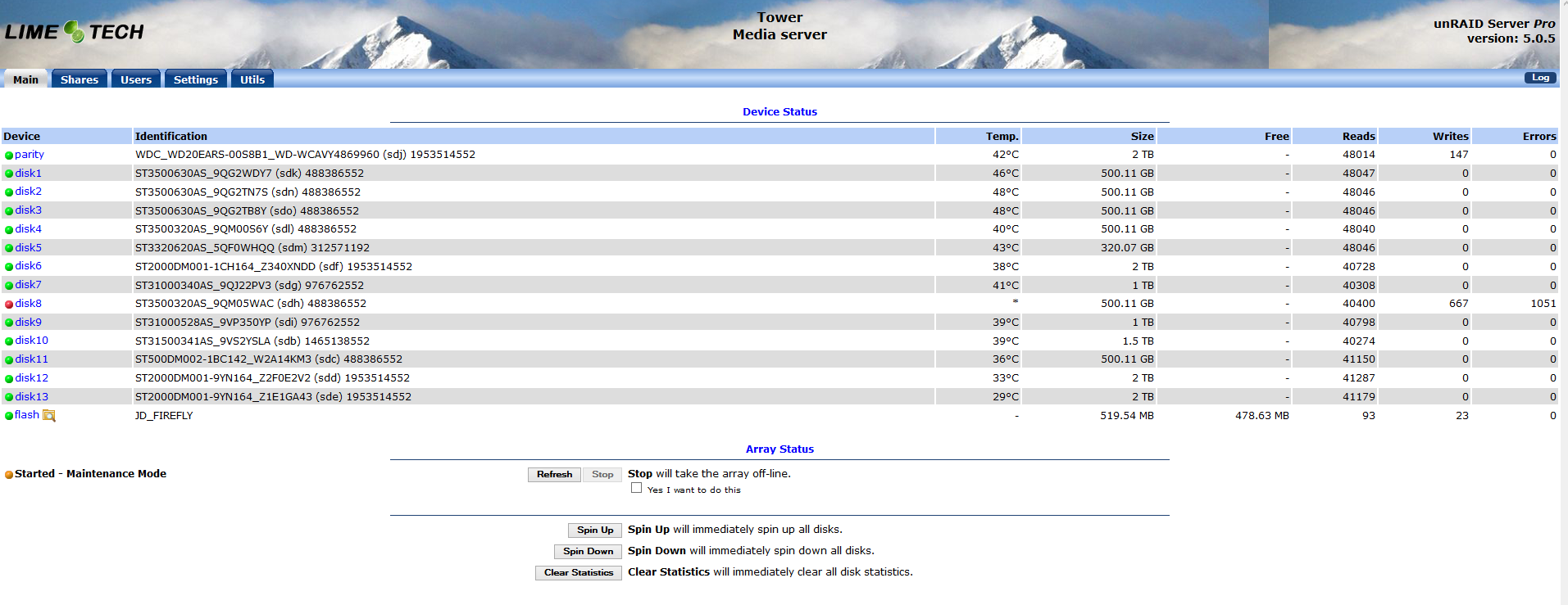

With 2 brand new 3TB drives I can't yet put in and drive 8 now gone red.  (and only a mater of time till drive 3 dies)
Should I swap out disk8 with the 2TB drive from my main computer and see what happens hoping that parity built last time and therefor would rebuild disk 8 this time,  It was good last time before the hard boot.  But wanted to rebuild, see notes above.
Is there some sort of command or something I should do first.
Worst case senario I suppose is that I lose the contents of 8 and rebuild the parity again.  Then I could continue and get drive 3 replaced before it dies.  I do have a full listing of most of the tower but its by share not by drive.  Its just a file list generated and put dropbox, there is no checksum data to know whats corrupt.  It was just a list for checking from work or my phone if I had a certain movie or show without having to remotely access my network.  So I don't know exactly what was on 8.  I could do a new listing after I get it all fixed and compare the two to find out what was originally on 8.  Doing that, I should at least be able to figure out what I lost.  Hopefully it won't come to that.  In the future I'll have to somehow put a system in place to better track this.
