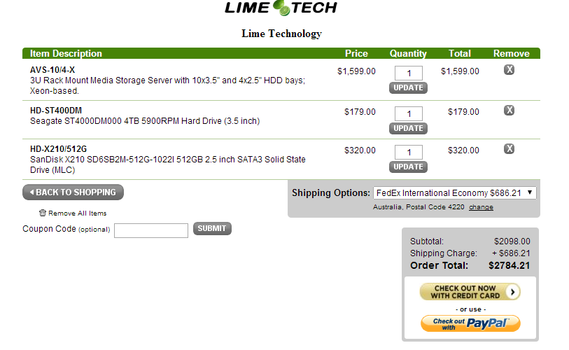

I'll wait for Tom to have a look at the order (attached) I would be willing to spend approx $400 on shipping.
As a person who builds and sells unRAID servers that shipping price is not to bad really.  A fully insured server shipped across the pond can run you near $800.  I am currently building 2 that are going to Thailand and shipping is not cheap for sure.
I have used Shipito as a intermediate stop.  Basically it allows us, the builder to ship and insure for a local US shipment, and then from there the buyer works with Shipito to get it to it's final destination.  This usually ends up working out a bit cheaper then a direct shipment across the pond.  The only way you get good prices for shipping over seas is if you are shipping pretty large volumes and I know I don't qualify for that sort of treatment.
I have checked out ShipitTo and the others but would prefer it shipped direct from the supplier. I have lost items before using re-shippers, thanks for that though.
Plus local shipping + assembly + au markup on parts cancels out most of the shipping cost.
You also have to take into account customs fees.  Most of my customers "forget" about that part until I mention it.  I do not cover customs fees, as I leave that up to the customer but depending on where it is going it can be a little chunk of change.
I have had a few customers ask about declaring the value of the shipment to be considerable less than what it is, that is never a good idea for the seller.  We have no way of recouping the cost of the build when we do that and if something should happen during shipment.  I have only every had one server arrive over seas dented and dinged, thankfully since it was covered fully the shipping company took care of covering all the replacement parts and shipping.
Good point it will be over $1000 so if customs catch it they will ask for some money. I can't see them taxing me in the shipping costs or the costs up to $1000 so it shouldn't be much.
