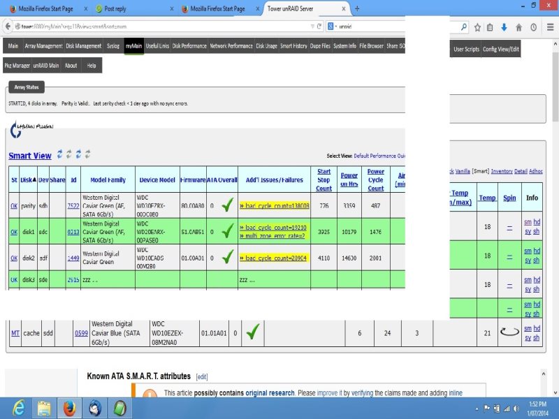

June 30, 201412 yr Author Ok, ata15 is my disk 8. Ran smart test again, and this time I do have 4 errors. This is an older disk, so I will replace it right away. I recently swapped my cache drive due to CRC errors with that disk. Before that, I had no errors or issues, nothing else had changed. After swapping the cache drive, I have the errors I posted in this thread. This is why I thought it could be cables. However, now ata15 or disk 8 is showing smart errors. I'm going to move my data off of disk8 and remove it from the array. I'll swap after I get a new disk and have precleared it. I'm also going to replace all cables - just to be sure. Once I do all of this, I'll review the log again and see if any errors return. Thanks1
July 1, 201412 yr Just before you close this switch i have the unmenu gui though i love this one feature i think yours dynamix has it not sure, just uses smartools in a nice easy way with error wiki help Yer command lines fine but being able to have the wiki included always you to understand each error is a screen shot. Clad you got this done and dusted bud

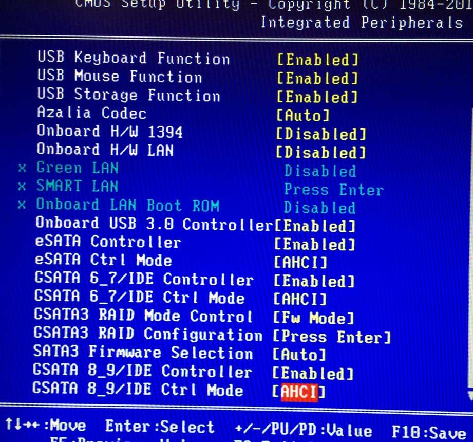

July 26, 201412 yr Author Update: I swapped the power cables and the issue remained with the same drives / ports. Not a power issue. I then swapped the SATA cables and the errors stayed with the SATA ports, meaning these ports are now connected to different drives. No reason to post syslog again, as the errors are exactly the same as in my previous posts. Both ATA15 and ATA16 generate these errrors. These two ports are the onboard Gigabyte SATA2 - ports 8 and 9. It does matter what drives I connect to these ports. When I run a parity check, the errors occur. It is still not clear to me if these are errors to be concerned with. I will send PM to Tom and Joe. The specs for these two ports from the manual are: GIGABYTE SATA2 chip: 1 x IDE connector supporting ATA-133/100/66/33 and up to 2 IDE devices 2 x SATA 3Gb/s connectors (GSATA2_8, GSATA2_9) supporting up to 2 SATA 3Gb/s devices Support for SATA RAID 0, RAID 1, and JBOD I've uploaded screenshots of the bios settings as well, as perhaps it's something I have set incorrectly. There is one option where by default it is set to Auto for Firmware Selection for that SATA 2 controller. Auto tells it to update and use the newest firmware from the system bios. The other option is to make it use the firmware on the chipset itself. i have not tried that because I don't know enough about this stuff to know it's safe to try it. With any errors, I would like to figure out how to resolve these. Any help would greatly be appreciated.
July 26, 201412 yr You've clearly isolated this to the two GSata ports on the motherboard. Whether it's anything to be concerned with I'll leave to Tom or Joe (or another Linux expert who can evaluate whether or not those resets are anything to be concerned about). My guess is everything's fine ... I'd just leave everything as is and not worry about it. Although the OCD in me would probably cause me to not use those ports unless I had to ... if you have spare ports on an add-in card, use those instead -- and then you won't have those extraneous lines in the syslog
