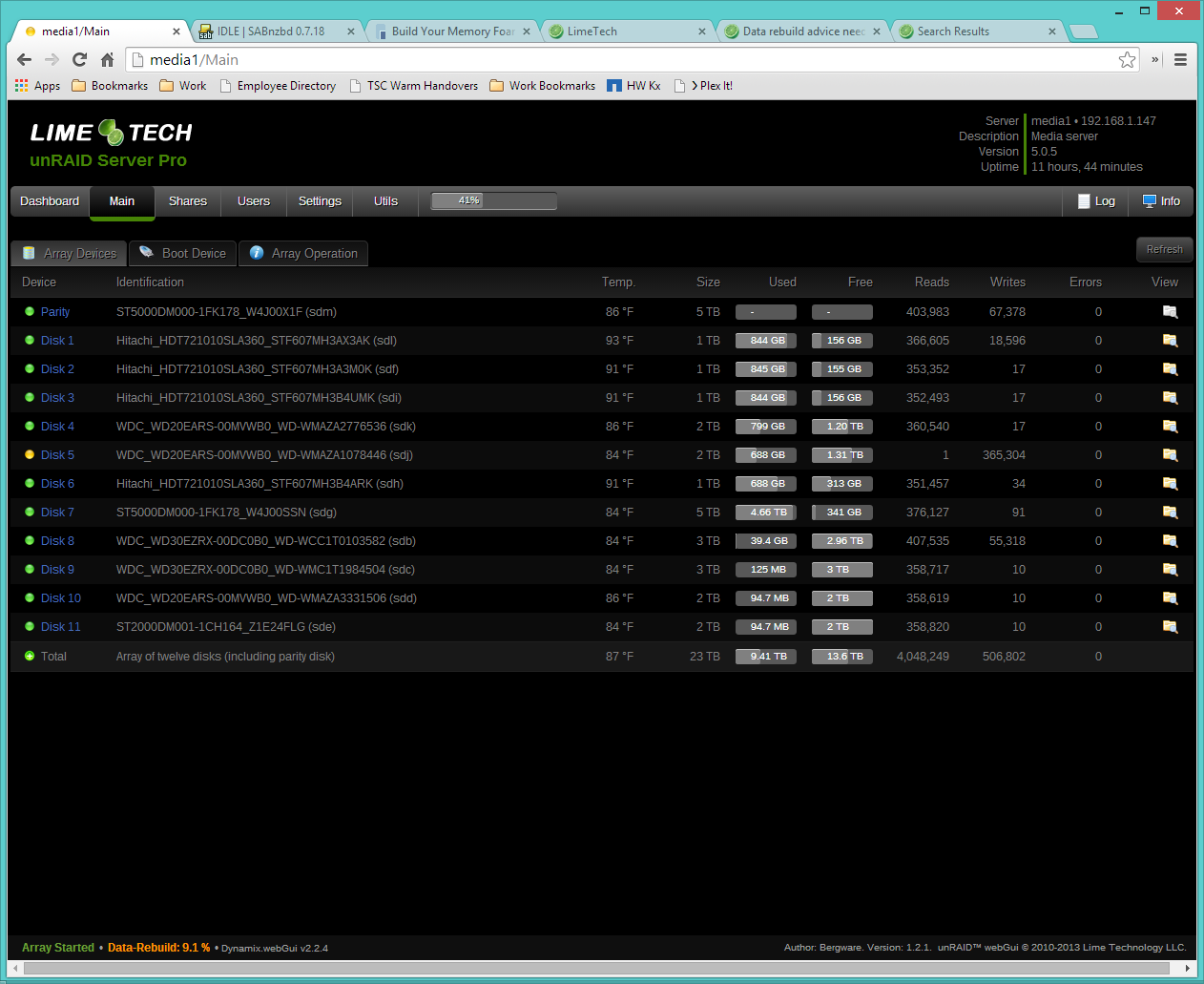

July 17, 201412 yr Author I think you meant "What kind of 5tb drive?". Sorry I misunderstood. Here is a screenshot of my current disks...
July 17, 201412 yr I think you meant "What kind of 5tb drive?". Sorry I misunderstood. Here is a screenshot of my current disks... Yes - sorry I can't type. Did you pull this drive from a Seagate external? Read THIS post.
